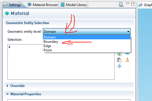

I'm not sure I catch all, but
Have you tried to define a second material node (same material as the bulk) and apply them to the boundaries ?
Or you might specify a boundary material property manually in the boundary physics node
Hi I'm not sure I catch all, but Have you tried to define a second material node (same material as the bulk) and apply them to the boundaries ? Or you might specify a boundary material property manually in the boundary physics node -- Good luck Ivar

Yes, I did that to make it work, but it seems sloppy and silly to have to say that the boundary is the same material as the domain. I was hoping for a more elegant alternative.
For example, on the heat transport mode, you select a material for a domain but you can add a boundary condition such as 'surface to ambient radiation', which uses the emissivity of the material. Therefore, it looks like the material which is on the domain level, is still accessible on the boundary level.
Yes, I did that to make it work, but it seems sloppy and silly to have to say that the boundary is the same material as the domain. I was hoping for a more elegant alternative. For example, on the heat transport mode, you select a material for a domain but you can add a boundary condition such as 'surface to ambient radiation', which uses the emissivity of the material. Therefore, it looks like the material which is on the domain level, is still accessible on the boundary level.

I assigned materials to the boundaries and then I got the error that the corresponding domains needed a material
