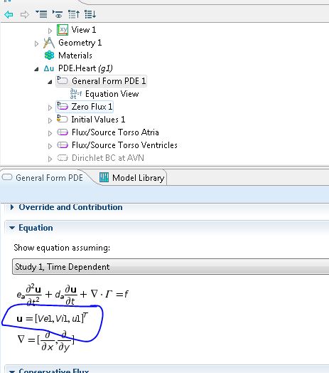

my variables are Ve1, Vi1, U1.

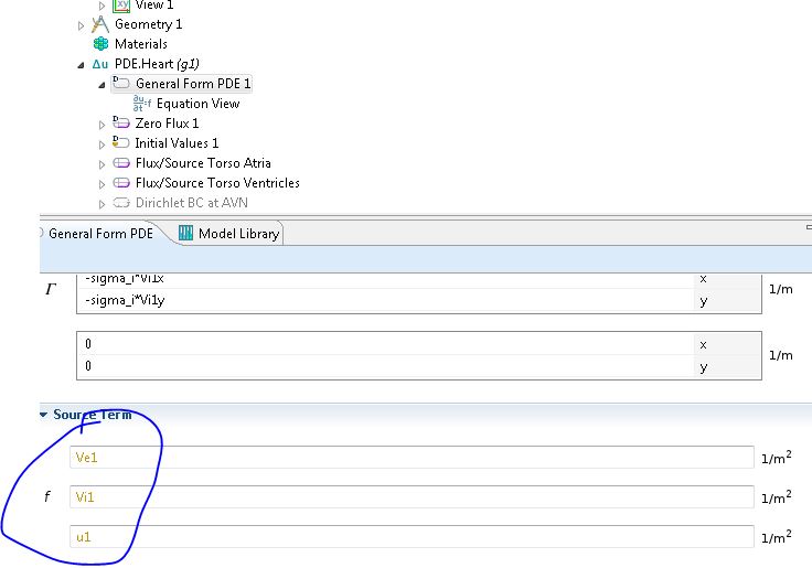

In pde equation when I substitute these variables in the source term, they appear in light brown color.
Why is this so? Attaching screenshots.
Somebody please help/ Thanks in advance.

That's COMSOL's way of warning you that the dimensions of your inputs are inconsistent with what the software was expecting. From your screenshot, the source terms are expecting inputs with a dimension of 1/length^2 (i.e. units of 1/m^2).
That's COMSOL's way of warning you that the dimensions of your inputs are inconsistent with what the software was expecting. From your screenshot, the source terms are expecting inputs with a dimension of 1/length^2 (i.e. units of 1/m^2). Best, Jeff

I found that the simulation completed though the entry is inconsistent. In such case what value is assumed for these ? is the software completing the simulation asssuming the values to be zero ?
Posted: 7 years ago 2018年12月19日 GMT+1 14:46
Yes, it's a warning, not an error, so the software can complete the run, but it is pointing out a location where you may have made a mistake. If you know what you are doing, you can ignore that warning. A typical case where you would ignore the warning is if you intentionally left out a multiplicative constant that would have given the right dimension to your input. For example, if an input field expects a force (N), and you type a displacement (m) because you know that the associated stiffness is 1[N/m].
Yes, it's a warning, not an error, so the software can complete the run, but it is pointing out a location where you may have made a mistake. If you know what you are doing, you can ignore that warning. A typical case where you would ignore the warning is if you intentionally left out a multiplicative constant that would have given the right dimension to your input. For example, if an input field expects a force (N), and you type a displacement (m) because you know that the associated stiffness is 1[N/m]. Jeff
