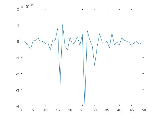

I try to simulate a waveguide and I see that the polarisation vector and the k vector are not orthogonal.
I did it by the attachment mph file and taking the data into a MATLAB script to take a dot product between the vectors to check if they are perpendicular.
what I have found is that these vectors are not orthogonal excluding in the plane z=0 but in every other place it isn't. which is not expected according to theory.
Is anyone encountered in such similar case?
thanks in advance

Thank you for your detailed reply
You are right about a waveguide where there is indeed an effective K vector but there is not expectation for a big change so they will not be vertical at all.
But in a simple case like the file I was uploading would expect that at least there will be symmetry around the center of the box (it isn't even a waveguide, just a box) and in the plane Z = 0 when the light progress direction is X indeed they are vertical and even on the sides of the box, but in the rest of the box they are not vertical (the dot product values are close to 1) that seems a little strange.
thanks again
Thank you for your detailed reply You are right about a waveguide where there is indeed an effective K vector but there is not expectation for a big change so they will not be vertical at all. But in a simple case like the file I was uploading would expect that at least there will be symmetry around the center of the box (it isn't even a waveguide, just a box) and in the plane Z = 0 when the light progress direction is X indeed they are vertical and even on the sides of the box, but in the rest of the box they are not vertical (the dot product values are close to 1) that seems a little strange. thanks again
