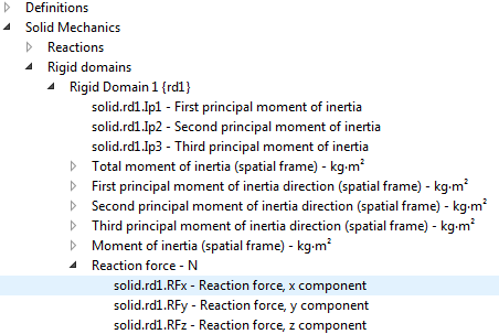

I assume that you are referring to the Prescribed Displacement/Rotation subnode on a Rigid Domain.
You need to select the Evaluate reaction forces check box in the Reaction Force Settings section. Then, reaction forces will be available when you work with global results, as shown in the attached screenshot.
Henrik
Henrik Sönnerlind
COMSOL
Hi, I assume that you are referring to the **Prescribed Displacement/Rotation** subnode on a **Rigid Domain**. You need to select the **Evaluate reaction forces** check box in the **Reaction Force Settings** section. Then, reaction forces will be available when you work with global results, as shown in the attached screenshot. Regards, Henrik

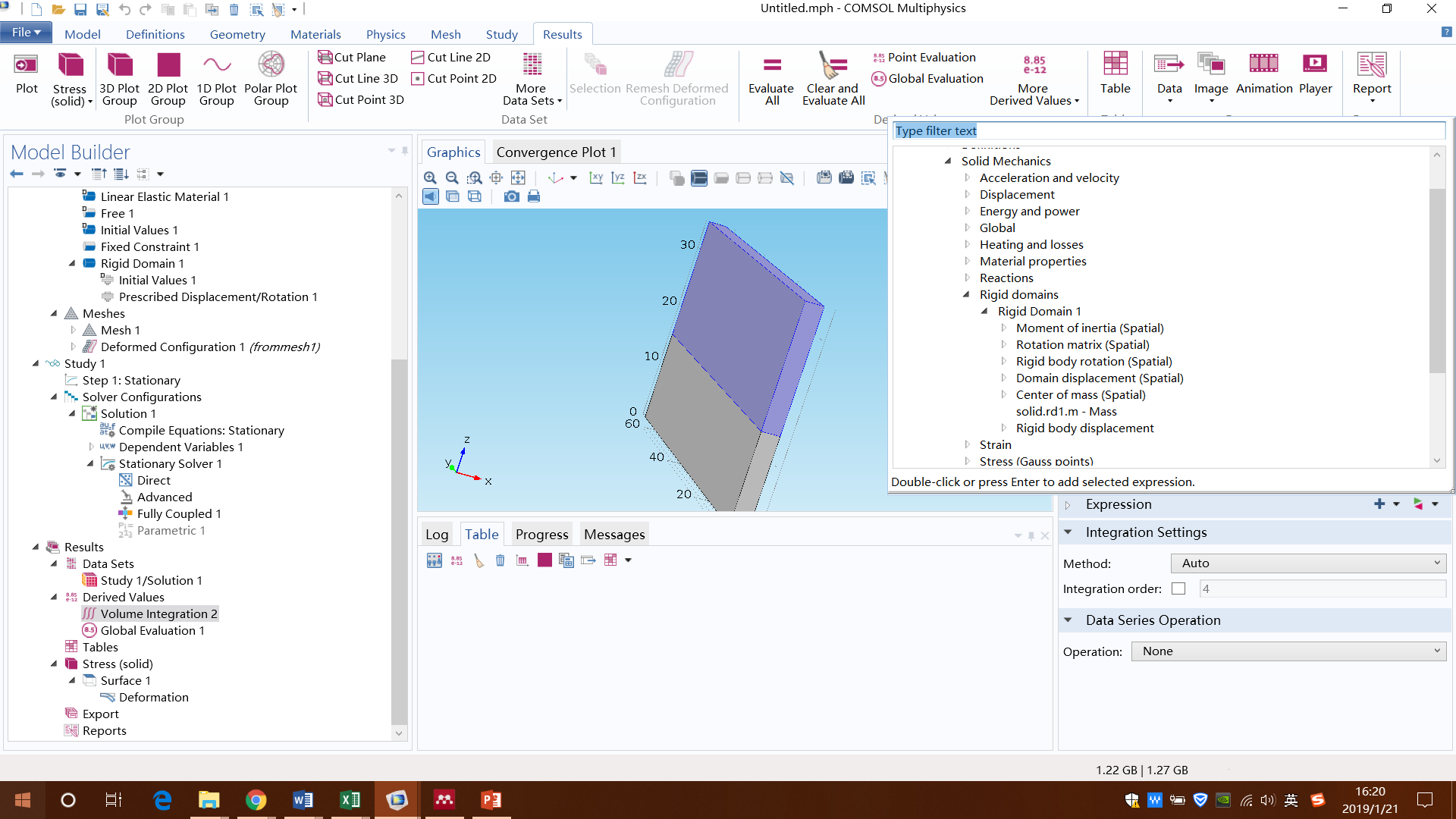

Thanks so much for your reply!
However, I didn't find the reaction force under rigid domain section.
I attached the screenshot below.
Could you tell me where I did it wrong?
Thanks, Ke Wu
Thanks so much for your reply! However, I didn't find the reaction force under rigid domain section. I attached the screenshot below. Could you tell me where I did it wrong? Thanks, Ke Wu
Posted: 7 years ago 2019年1月22日 GMT+1 09:39
You need to do a Global Evaluation. The reaction force on a rigid domain is a scalar result and not a field in the domain.
Henrik
Henrik Sönnerlind
COMSOL
Hi, You need to do a **Global Evaluation**. The reaction force on a rigid domain is a scalar result and not a field in the domain. Regards, Henrik
