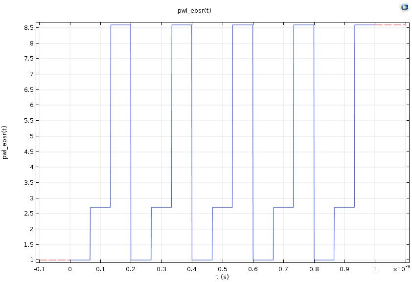

Hello everyone, I am doing a 2D time domain simulation now. The system contains two layers, the top is air and the bottom is a mateiral whose permittivity changes in time and is step-function like (I defined a piecewise function called 'pwl_epsr' in the global defination). You can leave alone the background of this problem, because it is just a simplified model. Please see the attached Fig1 and Fig2 for the schematics of the system and the permittivity profile of the bottom material.

I guess there is no problem with my source because I have benchmarked it. The only thing that can go wrong is the material. I suspected that the abrupt change of material property is intrinsicly unphysical, so I smoothed it using the built-in smoothing function. I also adjusted the time step to increase accuracy according to the guidance here. But none of the methods worked. Can anyone help me with that? *I have attached my simulation file, you just need to run it and see some plots and animations I've made. *Thank you very much!
