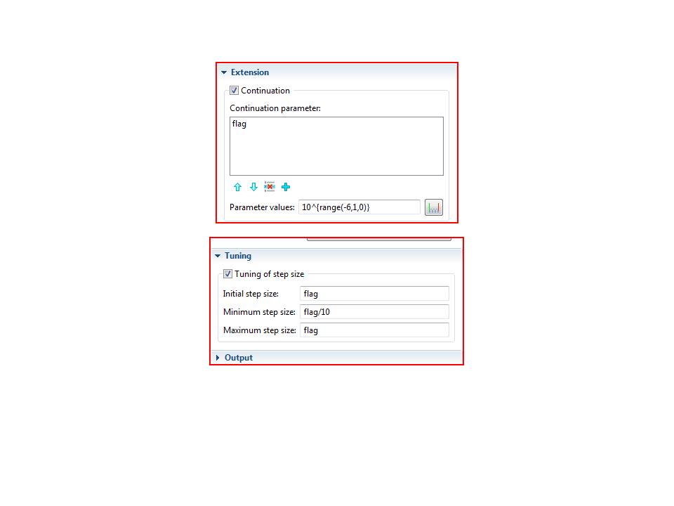

for continuation of a stationary solution I use a "flag" in the range of 1e-6 to 1 in steps of 1e-6, 1e-5, 1e-4, .., 1e-1, 1.
By tuning the continuation parameter the solver should use a step of flag/10 during solution process.
Is there a way to access the parameter value during solution for tuning? I defined a "flag" in the parameter list and use it as continuation parameter.
For tuning the parametric solver the algorithm doesn't use the actual parameter value but the "flag" from the model's parameter list (flag=1e-6).

I would rather use a "strict" stepping and define each position, see the solver sub tab
Hi I would rather use a "strict" stepping and define each position, see the solver sub tab -- Good luck Ivar
