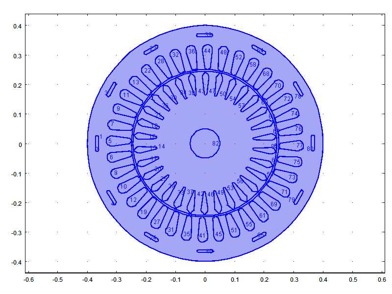

Hi all,
I have a model of an induction machine, which is attached in the file. In this model, besides stator and rotor laminations there are still holes located in the stator lamination that I try to make to change the rotational iron loss in the machine. These holes may be for ventilation system. Assuming that, across area of holes is kept constant. But the shape and position of these holes will influence the magnetic flux density as well as magnetic field strenght, then resulting changes on iron losses of the stator core. Therefore, to find an optimal position, we need an optimization method in the comsol model.
Based on this, I have some questions that I need your help.
1- How to build up a iron loss model (or hysteresis loss model) in the induction motor model? So far I do not know how to obtain iron loss distribution in the model. I want to compare iron loss distribution with and without holes.
2- Is it possible to adopt an optimization method to obtain optimal location of holes, which offers a minimum iron loss. Genetic algorithm can be used or developed in Comsol? Is there any references about this?

Hi Vincent,
I also dont know why it is impossible to open with 4.2. I will try to create a model with 4.2 version. But it can open with 4.0 because I created it with 4.0 version. If you can open it you can see its area. To make it clear, I attach a picture of the model.
Iron loss is composed of hysteresis loss and eddy-current loss. So I think this problem may be related to hysteresis issus that can be done using AC-AC capability of Comsol. It's my idea.
Now I just try with stationary type to check magnetic flux density. How is the time dependent or frequency domain? Which should be used? As I said I don't know how to investigate iron loss distribution in the model so far. Can you say more about the body heat source that is the function of local B and frequency?
The position of holes (near or far from the shaft center) will affect magnetic flux density in the model. I want to find an optimal position to obtain a minimum iron loss in the stator core. That's something I try to do.
