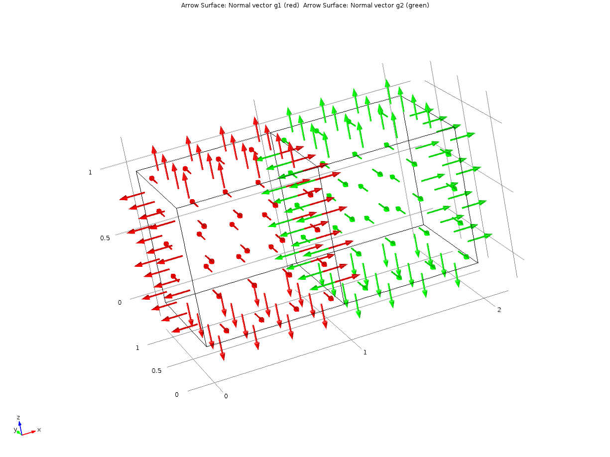

You have access to "physics interface normals" for all physics interfaces (including PDE interfaces) in version 4.2a (and earlier versions, at least since 4.0). For exampe, if you have two General Form PDE interfaces, g1 and g2, you refer to them as g1.nx, g1.ny, and g1.nz for the normals "out" from the domains where g1 is active and g2.nx, g2.ny, and g2.nz for the normals "out" from the domains where g2 is active. For an Arrow Surface plot, for example, these normal vectors are predefined plot quantities. See the attached image for an example where g1 is active in the left block and g2 in the right block.
Magnus Ringh, COMSOL AB
Hi, You have access to "physics interface normals" for all physics interfaces (including PDE interfaces) in version 4.2a (and earlier versions, at least since 4.0). For exampe, if you have two General Form PDE interfaces, g1 and g2, you refer to them as g1.nx, g1.ny, and g1.nz for the normals "out" from the domains where g1 is active and g2.nx, g2.ny, and g2.nz for the normals "out" from the domains where g2 is active. For an Arrow Surface plot, for example, these normal vectors are predefined plot quantities. See the attached image for an example where g1 is active in the left block and g2 in the right block. Best regards, Magnus Ringh, COMSOL AB

Thanks to both because of your helpful comments. The way Ivar suggested seems to be interesting but the Magnus is easire. Actually I also had implemented the Magnus method. I had been looking for a way to use the application mode normal vectors, however, because of the different ways of implementing them in previous versions (n_g) and new version (g.n) I were not able to use them. Fortunately, I found the way and it works perfectly.
