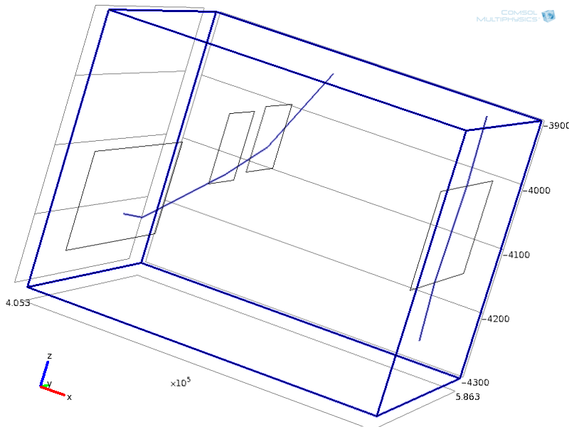

I have four 2D Bézier polygons (rectangles) and two 3D Bézier polygons (tubes) integrated within the 3D (extruded) block. I assigned Darcy's Law (Darcy's Law Material Model and Storage Material Model, (maybe) fracture flow and mass flux as well).
Meshing goes well - disable Darcy's Law, the simulation went well with good postprocessed GUI of mesh size and mesh quality.
Anything I might have missed out?

For me it sounds like you are missing a boundary conditions, your ODE are not enough defined, check if all physics have consistent BC's
Hi For me it sounds like you are missing a boundary conditions, your ODE are not enough defined, check if all physics have consistent BC's -- Good luck Ivar

yet, I did define BC for all geometries i.e. Storage Material Model for each of them, but to no avail.
you talked about 'consistent BC', how to make sure a consistency? I mean, anywhere to check that?
