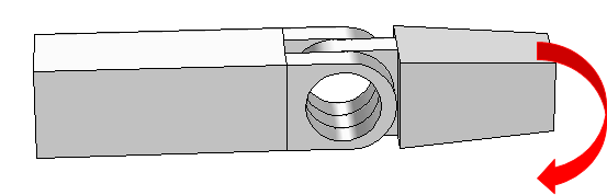

Hi all,
I've modelled a hinge with structural mechanics module via a rigid connector. Can anyone tell me how I can move (rotate) the connected solid object along the axis of the pin hole?? I've attached the model file and a photo for better understanding.
Many thanks
Shaghayegh

Dear Shaghyegh,
It seems you are using Form union in the geometry whereas for multibody modeling, in order to allow relative motion between the two components, geometry should use Form assembly. Note that before using Form assembly you need to use one or several Union nodes in geometry for domains of each component if they are not already in union state.
You can also refer hinge_assembly model from Application Library for more details.
Best regards, Pawan Soami
