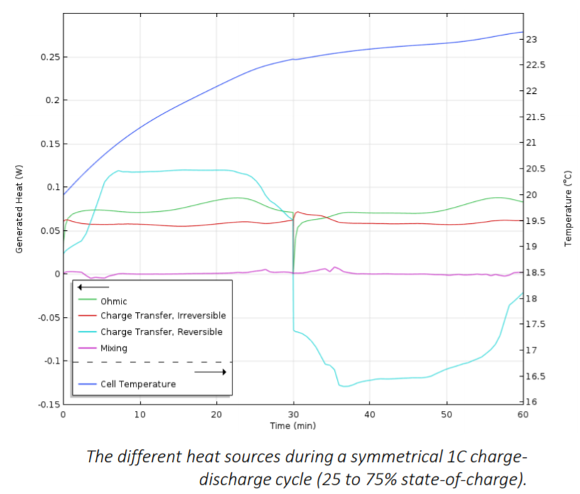

I am trying to plot heat generation from Li-ion cell.
I am referring to the thermal modeling example(for COMSOL 5.3) and using the same model published here: https://www.comsol.com/model/thermal-modeling-of-a-cylindrical-lithium-ion-battery-in-2d-10221
I want to plot the heat generation from the cell during the whole cycle as shown below. Image attached. Taken from: https://www.comsol.com/model/download/515011/Thermal_modeling_of_batteries_in_comsol_2daxi_LumpedBattery.pdf
