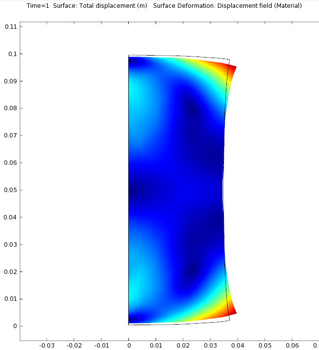

Hi, another thing i am would like to ask:
By plotting the deformation result in 2D plot group>surface (total deformation) and deformation (displacemnt field), I found that plot data set edge (black border line: in spatial frame) does not match with the edge of colour plot deformation (as shown in attached solid_displacement.png). I thought they should match each other?
Hi, another thing i am would like to ask: By plotting the deformation result in 2D plot group>surface (total deformation) and deformation (displacemnt field), I found that plot data set edge (black border line: in spatial frame) does not match with the edge of colour plot deformation (as shown in attached solid_displacement.png). I thought they should match each other?
Posted: 1 decade ago 2011年12月23日 GMT+1 10:11
well if you add the displacement ot an already "displaced" deformation you get it double up, this was an issue in 3.5 as you needed to uncheck the disp when turning on the spatial frame, but normally it's treated correctly in v4 (apart if you are tweaking the equations such that COMSOL does not understand)
Hi well if you add the displacement ot an already "displaced" deformation you get it double up, this was an issue in 3.5 as you needed to uncheck the disp when turning on the spatial frame, but normally it's treated correctly in v4 (apart if you are tweaking the equations such that COMSOL does not understand) -- Good luck Ivar
Posted: 1 decade ago 2011年12月23日 GMT+1 14:06

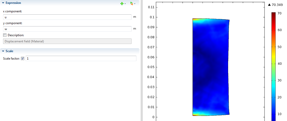

It’s either what Ivar just described above or you are scaling the deformation field in this plot. In that case, setting the deformation scaling factor to 1.0 should match the two plots.
Posted: 1 decade ago 2011年12月23日 GMT+1 15:32
Yea, it works after changing the deformation scale factor to 1.0! Thank you again, Ivar and Nagi!
