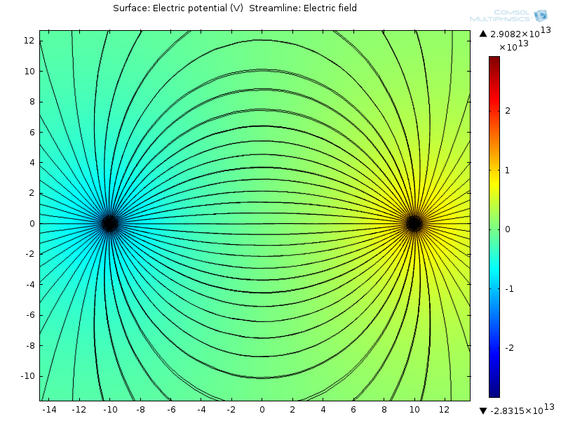

Posted: 1 decade ago 2013年2月6日 GMT+1 21:25
indeed you need to mesh the domain around your point charges, and give them some material info, but vacuum or air is not that much dfferent, but still its not the same as a "void"
By the way in 2D a "point charge", is in fact a long vertical wire along Z charged to a given value in Coulombs per meter, since 2D is a representation of 3D with an invariant along Z the out of paper direction

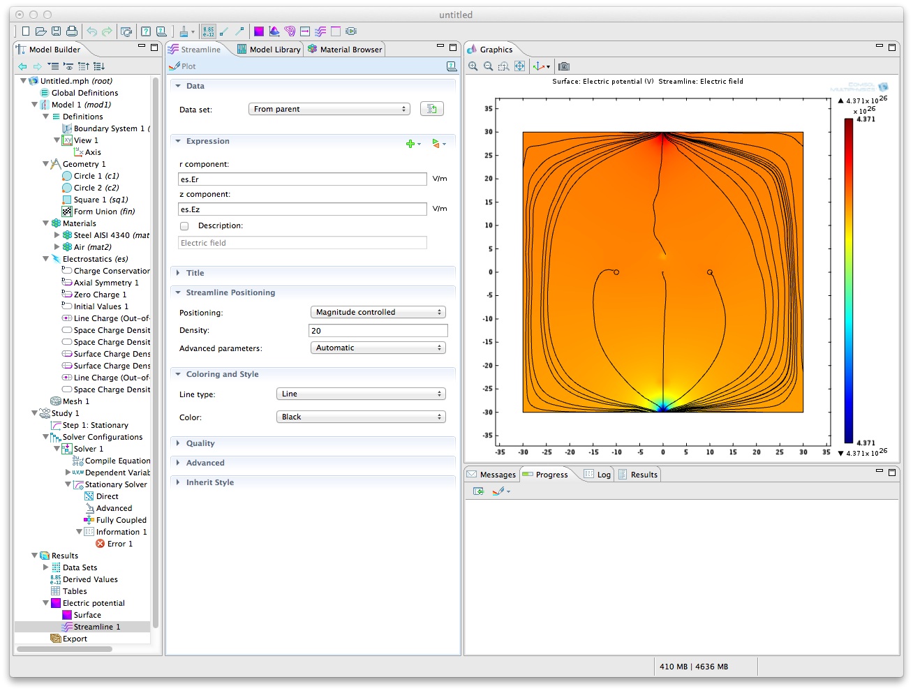

Thanks, Ivar. Your advise was helpful. Attached is an image of what I wanted to achieve. Thanks!
Posted: 1 decade ago 2013年2月7日 GMT+1 13:33
you should manage, in 2D try adding under "point" the line charge and give a + and a _ sign that should work. I'm off line for a weeks time so I cannot make an example (I'm not carrying my COMSOL WS all over Europe ;)
Hi you should manage, in 2D try adding under "point" the line charge and give a + and a _ sign that should work. I'm off line for a weeks time so I cannot make an example (I'm not carrying my COMSOL WS all over Europe ;) -- Good luck Ivar

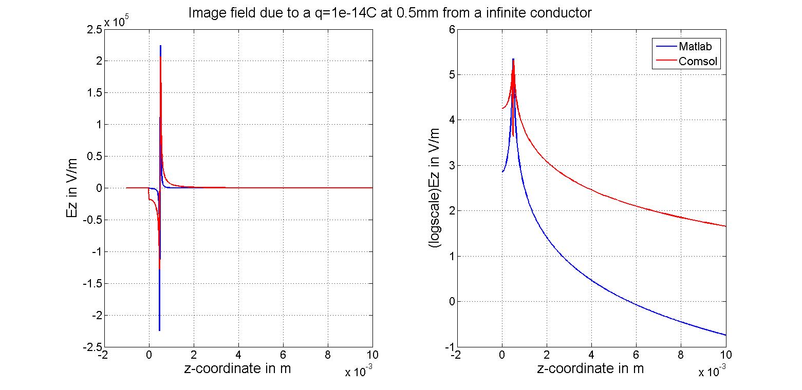

I was interested in finding image force on a charged particle near a conducting rod in comsol. Therefore as an initial check i simulated a charge near a conducting plate and compared the resulting image field to the field from analytic solution of charge on a infinite conducting plane. The results in these two case doesnt seem to match even if i increase the size of the conducting plate so that it appprox. an infinite plate.
Can you help me solve this discrepancy? Am i doing something wrong here?
