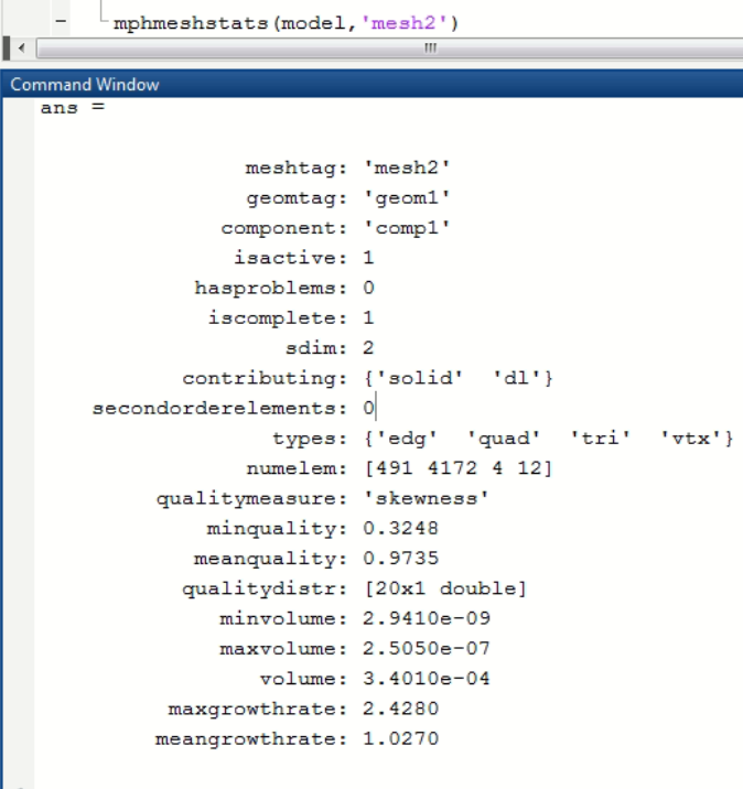

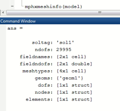

Hello Lars,
I need to do some calculations by using the Darcy's Velocity (dl.U) in element level and use this information for other calculations. I tried mphmeshstats and mphxmeshinfo functions and the outputs are given as screenshot below. It seems like it doesn't give me what I want. Do you have any other suggestions? Or should I do additional things with those functions?
Thank you,
Hello Lars, I need to do some calculations by using the Darcy's Velocity (dl.U) in element level and use this information for other calculations. I tried mphmeshstats and mphxmeshinfo functions and the outputs are given as screenshot below. It seems like it doesn't give me what I want. Do you have any other suggestions? Or should I do additional things with those functions? Thank you,
Lars Gregersen COMSOL Employee
Posted: 6 years ago 2020年1月29日 GMT+1 10:09
mphmeshstats has an extra output. See the LiveLink for Matlab User's Guide in the section titled "Extract And Create Mesh Information".
The output of xmeshinfo is a struct with a lot of sublevels which are not for the faint of heart.
