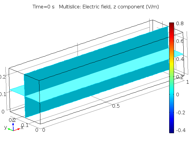

Sorry, I don't have version 5.0 installed and I don't see anything like an "export into 5.0 compatible" option.
Note to other readers: Any suggestions?
Meanwhile, below is the text from an exported .java file which may help you understand what I did. ( I understand that it may be possible to turn such listings into readable models, but I don't know the details. I saw some info about doing that at: www.comsol.com/community/forums/general/thread/46901 .) Good luck.

model.study("std1").feature("time").set("tlist", "range(0,1.0e-10,4.5e-9)");
model.sol("sol1").attach("std1");
model.sol("sol1").feature("t1").set("tstepsgenalpha", "strict");
model.sol("sol1").feature("t1").set("timemethod", "genalpha");
model.sol("sol1").feature("t1").set("tlist", "range(0,1.0e-10,4.5e-9)");
model.result().dataset("cpt1").set("pointx", ".5");
model.result().dataset("cpt1").set("pointy", ".125");
model.result().dataset("cpt1").set("pointz", ".125");
model.result("pg1").label("Electric Field");
model.result("pg1").feature("mslc1").label("Multislice 1.1");
model.result("pg1").feature("mslc1").set("expr", "temw.Ez");
model.result("pg1").feature("mslc1").set("descr", "Electric field, z component");
