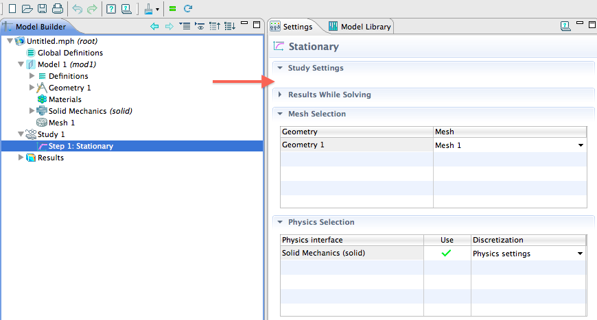

I have an odd problem. I am trying to recreate the Large Deformation Beam model (www.comsol.com/showroom/documentation/model/204/) before I start my own project to investigate buckling. I was following along with the model, but when I go to Study 1 > Step 1: Stationary and open Study Settings, I do not see any buttons that say "Include Geometric Nonlinearity". Indeed, I do not see any buttons at all.

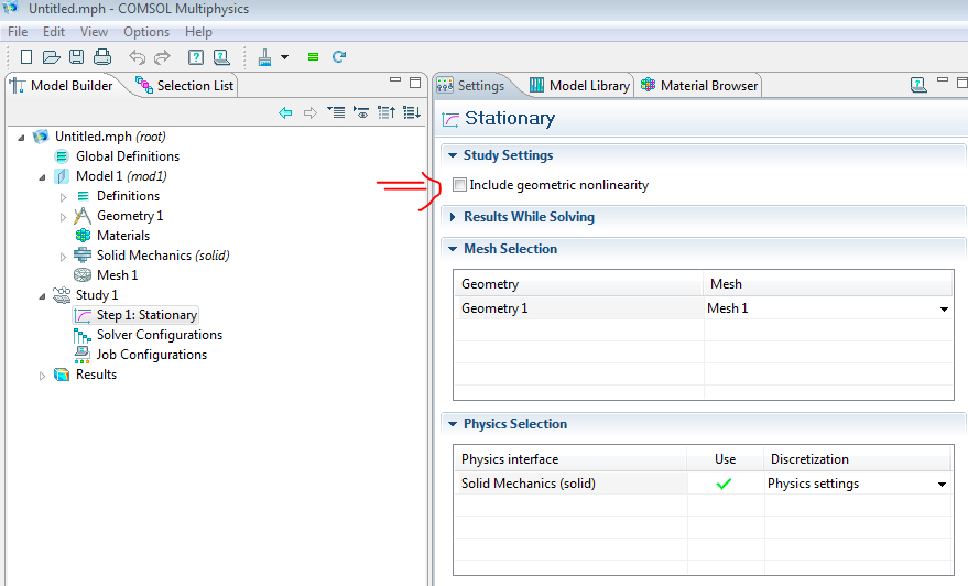

When I download the support file for the Large Deformation Beam model, I do see this button.
However, if I delete the stationary solver and add a new one, I do not see the button any more.
It seems like I must be doing something dumb here, but I can't seem to figure out what. Any help would be appreciated.

Hi Ivar,
Thanks for the quick reply. Unfortunately, this did not solve my problem.
I am using version 4.2a and the most recent patch (166). However, I still do not see anything that says "Include Geometric Nonlinearity" under the "Stationary" subnode (even when I create a new model from scratch). I also checked the "Linear Elastic Material Model" subnode under the solid mechanics node, but didn't see anything there, either.
Please let me know if their are any more suggestions.
Thanks again,
-jfb

Posted: 1 decade ago 2012年2月3日 GMT+1 17:13
I do (if I select solid, it depends on the physics (also .166 on Win-7)
Hi I do (if I select solid, it depends on the physics (also .166 on Win-7) -- Good luck Ivar
Posted: 1 decade ago 2012年2月3日 GMT+1 17:39
I don't (even when I select solid, on a Mac)
-jfb
Hi I don't (even when I select solid, on a Mac) -jfb
