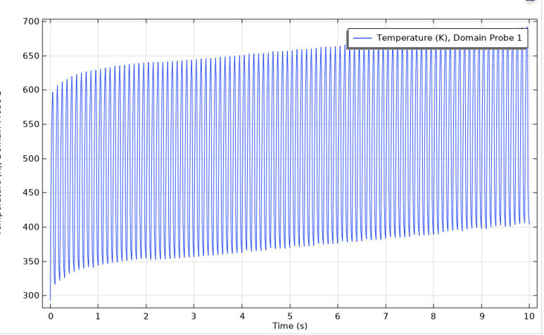

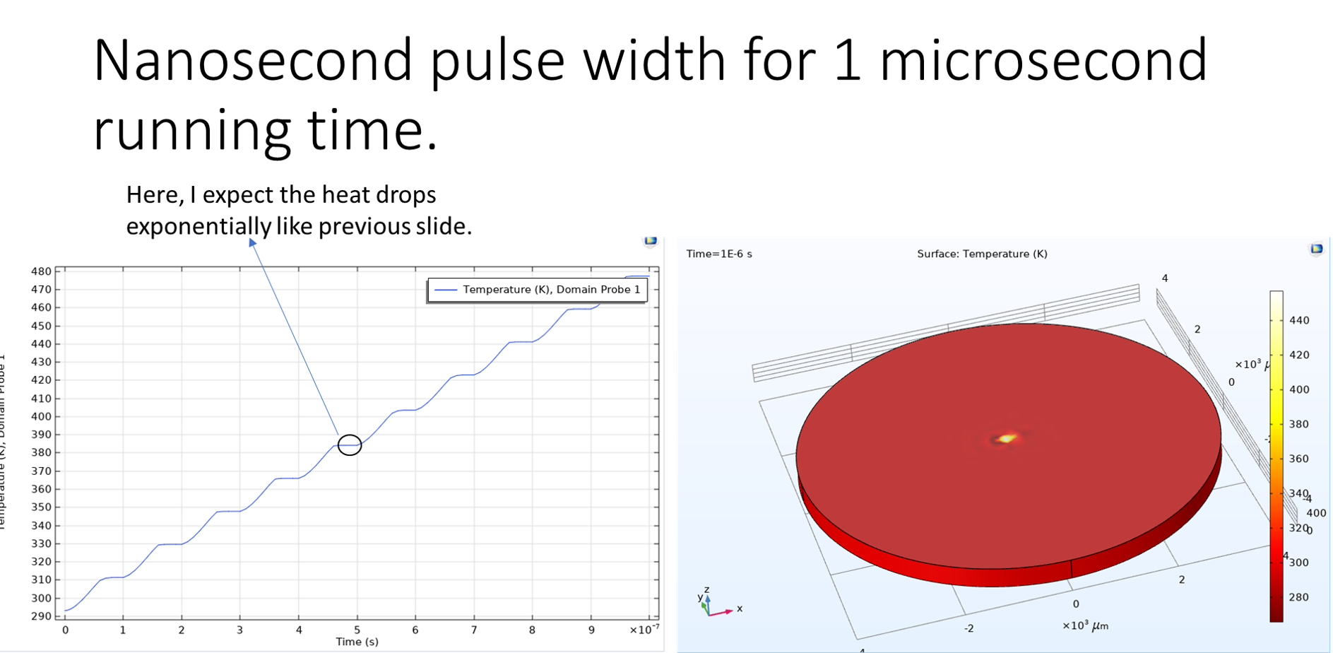

I am simulating pulsed laser material interaction. When th pulse duration is in milisecond range, I would get reasonable resutls. I mean as it would be expected the heat will be dropped down in off time of pulse. However, when I go to nanosecond and microsecond range, the heat won't drop down in off time (see attached figures).

It seems like thermal inertia at work. In Picture2.png, the temperature drops at an initial rate of a few thousand K/s. That same rate, applied to time intervals on the order of 1e-7s , in Picture1.png, results in temperature decreases that are 1/ too small to be noticeable on your graph, and 2/ smaller than sources of inaccuracy in your model (such as uncertainty on the model inputs) anyways .
Hello Zabi, It seems like thermal inertia at work. In Picture2.png, the temperature drops at an initial rate of a few thousand K/s. That same rate, applied to time intervals on the order of 1e-7s , in Picture1.png, results in temperature decreases that are 1/ too small to be noticeable on your graph, and 2/ smaller than sources of inaccuracy in your model (such as uncertainty on the model inputs) anyways . Best, Jeff
