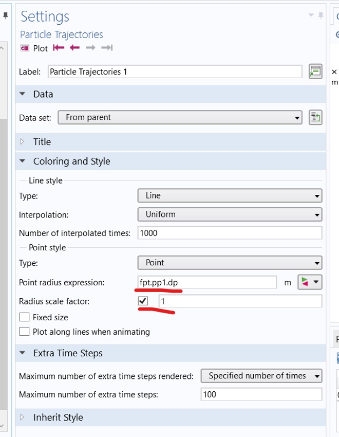

You have to set the particle diameter in "Particle Properties" . Then, to correctly visualize the particles in your results you have to do as follows:
  1. Go to Particle trajectories (ftp) in Results
  2. Click Particle trajectories
  3. Go to Coloring and Style section
  4. In Point Style select Point Radius expression you have to write: ftp.pp1.dp
  5. In Radius Scale factor you have to write: 1
I hope it can be useful to solve yours problem.
