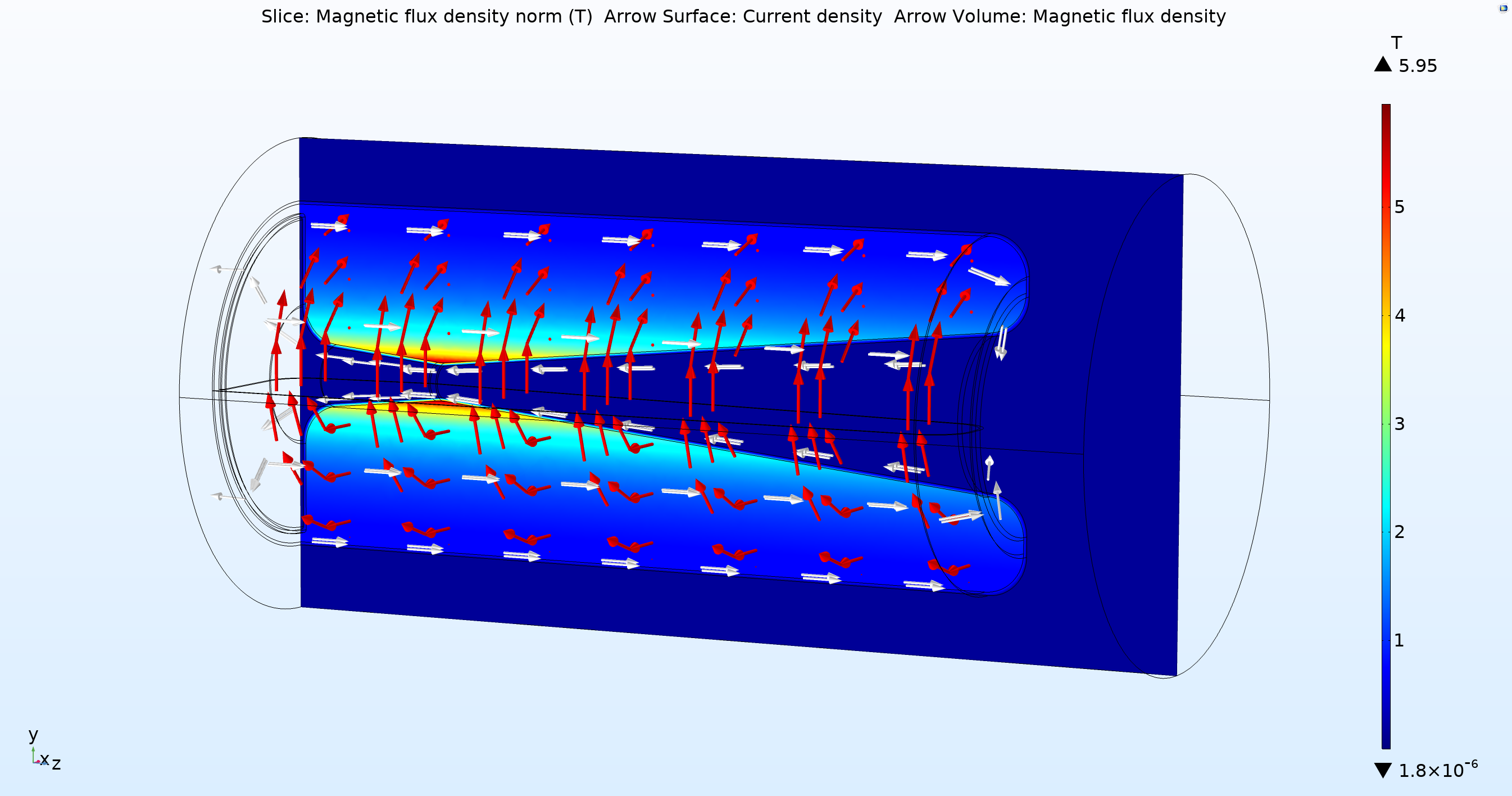

In my 3D model (prenested in the COMSOL Discussion Forumhere) I want to study the skin effect in the conductor body (in frequancy domian study). Because the condcutor thickness is very small and at higher frequencies the current is being driven closer to the boundaries, I need to apply much finer mesh (to the conductor domain) to resolve the spatial variation of the fields. With the structure large aspect ratio, it seems very diffcult for my computational resources to withstand this huge meshing matrix. Since my model is azimuthely symmetric, I decided to study it in a 2D Axial-Symetric reference farme (attached is a simplified model). However, I faced an "old" problem: how I can apply the current in r-z plane instead of normal to plane? I see that this issue was discussed decade agohere, however, I still cannot get how to do it. It also seems that there is a similar study done by COMSOL and publishedhere, but I cannot find details on this study!

The idea of the coaxial port seems the right way in this case, however: 1- Option "Coaxial" of the "Type of lumped port:" is not available for any of the AC/DC module physics nodes!! I am using "Magnetic field (mf)". 2- While it is different physics, I tried to guid myself abit with thisexample, to understand how the lumped port works. So, I defined the input and output ports (with terminal type = current), please see the attachment. However, this gave me non-understandable results. 3- I also tried to assign the terminal between the two conductors as you suggested, but still the solution is not correct.
Just for guidness, I also attach the corresponding/correct/expected result from the 3D model!

you need to set the mf physics to solve for in-plane vector potential, since you only want to see a phi-component of the magnetic field, right? Then the coaxial port gets available and your Lumped Port 3 is the correct way.

The solver sequence is not correct for the stationary study. The frequency domain step solves if you assign a small conductivity to the air domain, e.g. 1 S/m. Also you may need, or not, to add a Gauge Fixing node. Compare the results with and without, if the difference is significant you need it. It consumes some more memory.

Many thanks for your guidance throughout this case. It works perfect now.
As usual and in order to close this case in a useful way, I attach the working model as a reference for the future similar cases. I also want to state that the Gauge Fixing node was not making any difference for this specific model. However, as Edgar recommended, always check its infuence for each specific case.
