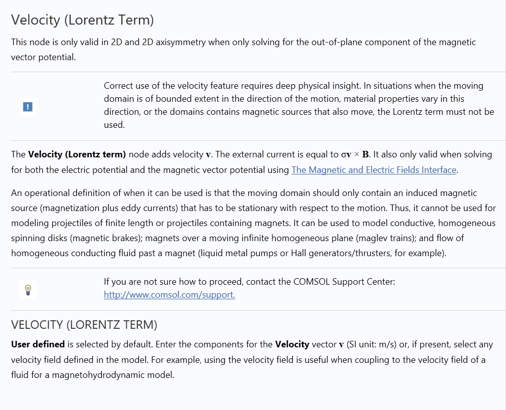

Yes, but this is the velocity of the medium, not the field. See the attached, from Comsol's help system:

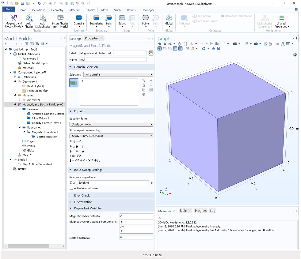

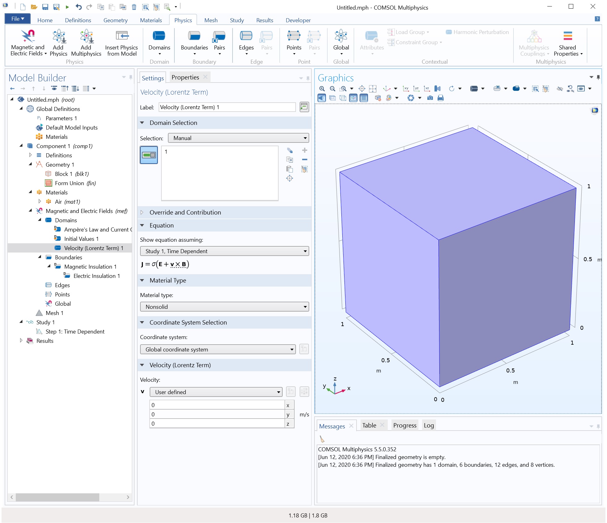

If you need to work with a material velocity in a 3D EM model, you could use the mef formulation, with a velocity term. This is available in the AC/DC module. See the screenshot images attached.
If you need to work with a material velocity in a 3D EM model, you could use the **mef** formulation, with a velocity term. This is available in the AC/DC module. See the screenshot images attached.
