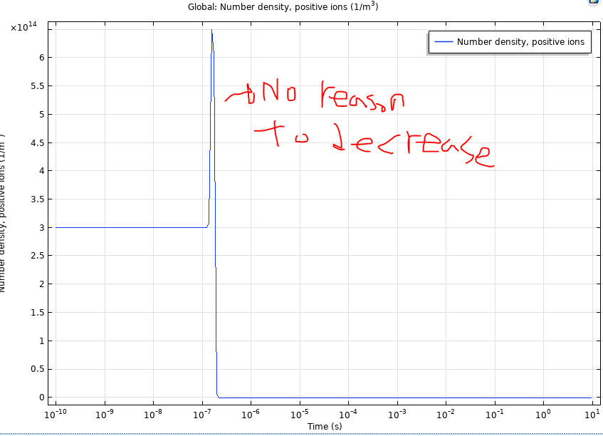

Why positive ion decreases even with no recombination?
Hello I faced a problem and i have no idea why this happens
I'm simulating a air discharge(N2, O2, H2O) in a pulse applied voltage
this is global model (0 dimension)
I'm simulating in a step wise manner
This is problem in a time sequence
  1. i noticed that electron decays even in a only ionizaiton reactions is enabled
  2. In theory guide, electron is calculated by summation of other ion's charge
  3. So after precise investigation, i noticed that positive ions decays right after the pulse discharge
  4. why this happen? I disabled all the recombination and attatchment ( my expectation is ion density remains constant after ionization, pulse)
  5. In 'equation view', there are no sink term in positive ions
  6. Anyone can help me?
