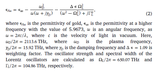

Besides the image you attached as an error in the formula, it should read
, instead of
. Or maybe it is

If I remove it, I get no unit error from COMSOL. The attached file is exported from the COMSOL interface, you can import it in your model.
Besides the image you attached as an error in the formula, it should read \Gamma_L^2, instead of \Gamma_L^{\omega}. Or maybe it is \Gamma_L \cdot \omega
