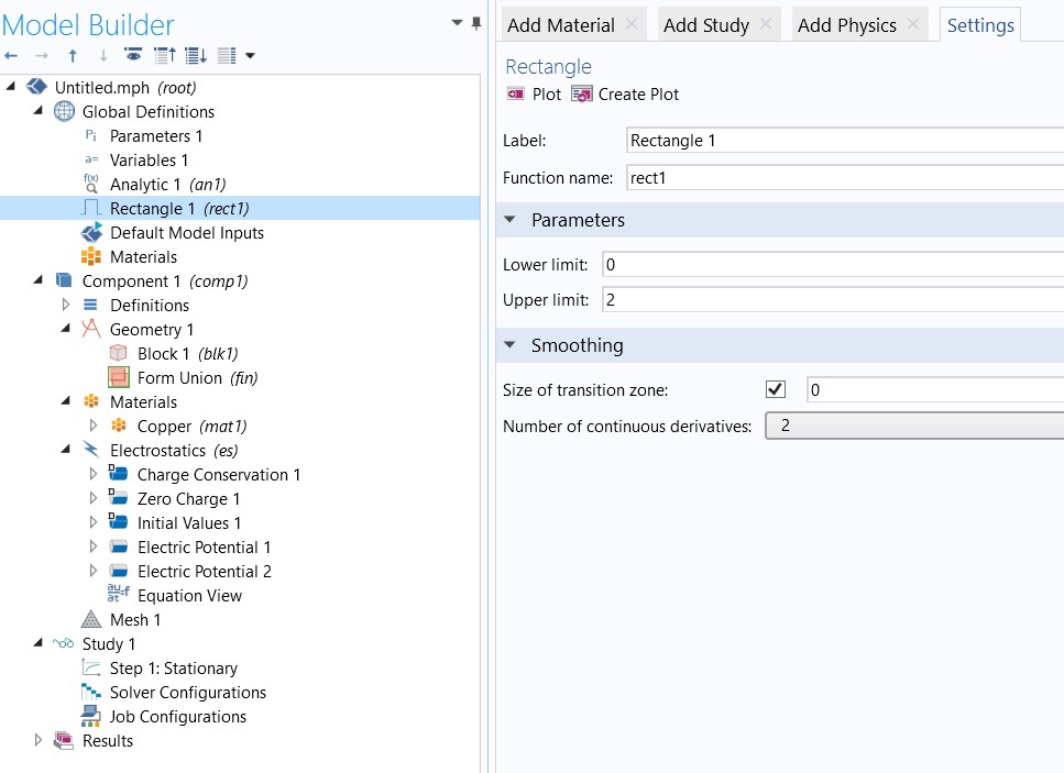

This can be done usingGlobal Definitions>Functions>Rectangle.
Alternatively, you can look-up "Events" in the user-guide. This is oftentimes better-suited for abrupt transitions like yours.
This can be done using `Global Definitions` > `Functions` > `Rectangle`. Alternatively, you can look-up "Events" in the user-guide. This is oftentimes better-suited for abrupt transitions like yours.

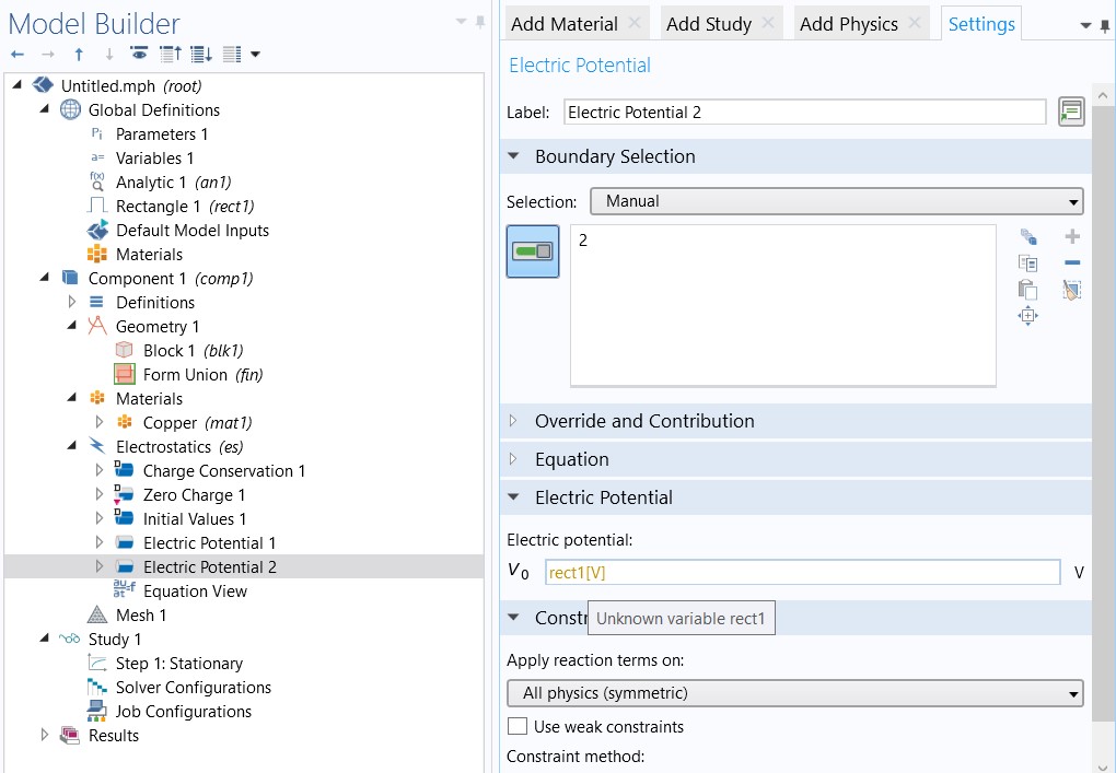

I was able to do this with analytic funtion, but finding difficult to doit with rectangle. By the way using events work like a charm. I am attaching the screencshot of using the rectangle function as potential, probable some error somewhere.

rect1is just the function name. You must call it with some argument.
For example useV0*rect1(sin(2*pi*f*t))to obtain a periodic rectangular function with frequencyfand magnitudeV0.V0andfcan then be parameters that you define (in volts and Hz, respectively), whereastis a built-in variable representing time.
But I think in your case, the functionwaveformis more appropriate, because you can directly selectType: SquareandAngular frequency: fto get the same result.
Anyway, the point is that the function must be calledfunc_name(argument)by something that is time dependent ;-)
`rect1` is just the function name. You must call it with some argument. For example use `V0*rect1(sin(2*pi*f*t))` to obtain a periodic rectangular function with frequency `f` and magnitude `V0`. `V0` and `f` can then be parameters that you define (in volts and Hz, respectively), whereas `t` is a built-in variable representing time. But I think in your case, the function `waveform` is more appropriate, because you can directly select `Type: Square` and `Angular frequency: f` to get the same result. Anyway, the point is that the function must be called `func_name(argument)` by something that is time dependent ;-)

Thanks Alexis, The problem is solved, I was only giving an argument as t, then my unit of potential won't be voltage. It was V*s, that were the problem. thank you very much for your help.
