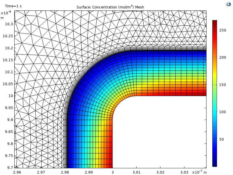

Sure thing. Here's the region in question. I've highlighted the region of negative concentration as you can see that the overall solutions are very similar.

So the negative concentrations are only located in regions where the concentration is nearly 0, right?

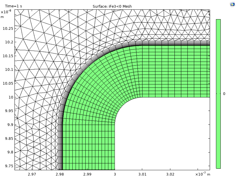

Could you change the data and/or color range so that the color bar's maximum is 0 ? I'm wondering if the magnitude of the negative concentrations might be neglected.
Also sorry to be inquisitive but your channel is only 2nm wide. Is this correct? It seems extremely narrow to me.
So the negative concentrations are only located in regions where the concentration is nearly 0, right? Could you change the data and/or color range so that the color bar's maximum is 0 ? I'm wondering if the magnitude of the negative concentrations might be neglected. Also sorry to be inquisitive but your channel is only 2nm wide. Is this correct? It seems extremely narrow to me.

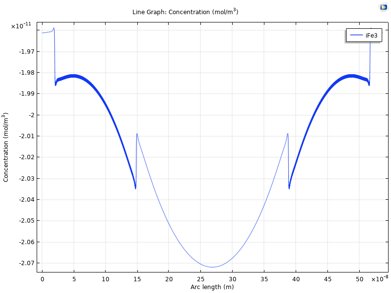

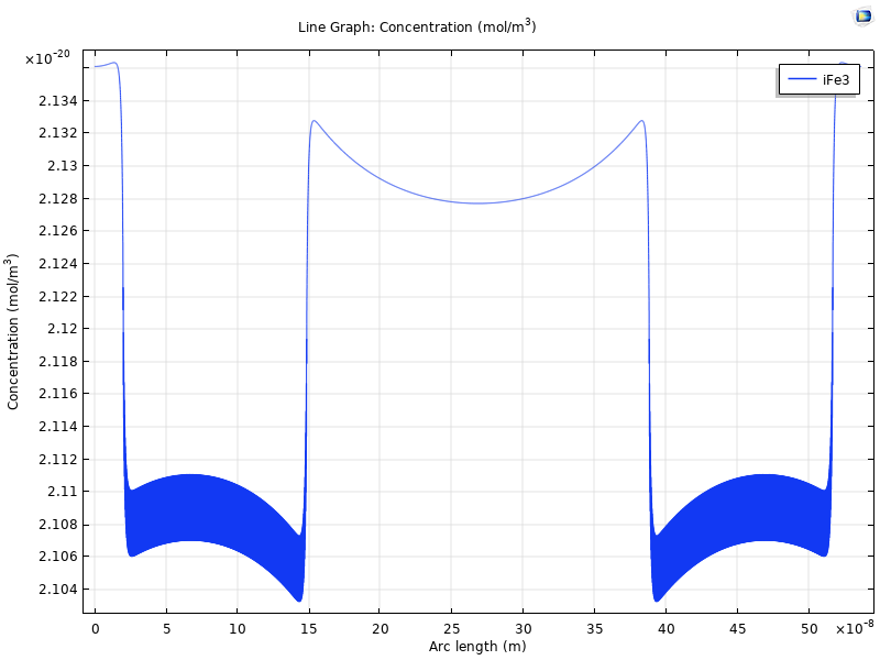

The domain is very small, I'm attempting to model the diffusion and migration of vacancies and interstitials in an passive layer. (Some further information here if you're interested http://dx.doi.org/10.1016/j.electacta.2012.02.008 ). After looking at the data to try and produce the plots requested, I've established that none of the mesh elements appear to be negative concentration. However if I plot the concentration along the outer boundary, or integrate along it I am given a negative concentration. See plots attached. I'm now thinking that this is a discretization issue as the concentration gradient is large at this boundary and the concentration should tend to zero. Perhaps the gradient across the mesh element is overshooting in the stationary case. I don't understand why I get different results between the solvers though.

I would not be very worried about these concentrations. After all ±10⁻¹¹ mol/m³ is essentially 0 for any practical purpose, when the typical scale of concentration is 100 mol/m³ The ratio between the two is in fact not too far from the representation limit of double precision floats anyway.
Another way to look at it is that over a volume of 10 × 10 × 10 nm³, this concentration multiplied by the Avogadro number is many orders of magnitude below 1 ion.
Very interesting system, thanks for the read! I would not be very worried about these concentrations. After all ±10⁻¹¹ mol/m³ is essentially 0 for any practical purpose, when the typical scale of concentration is 100 mol/m³ The ratio between the two is in fact not too far from the representation limit of double precision floats anyway. Another way to look at it is that over a volume of 10 × 10 × 10 nm³, this concentration multiplied by the Avogadro number is many orders of magnitude below 1 ion.
