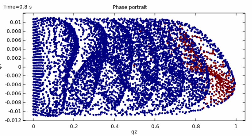

I am using the particle tracer module to analyze the axial mixing performance of a static mixer. Particles are being injected at the inlet at t=0, 0.1, 0.2, ... 0.8. During post processing results, I am using a 2d Plot group of a phase portrait along a longitudinal cross section of the static mixer (as shown in the attached image). X-Y plane is the cross sectional plane, Z is the axial.
I want the cross section of the particles injected at each of the times to be colored half blue and half red. I have been using the at(0,x<0), but it only seems to work when I am injecting particles at a single time t=0. How can I do the same for this case with injections at multiple times?
