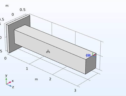

I have a beam fixed from one end and experiencing a harmonic displacement excitation as: y (t) = A sin (wt) [Figure 1 is attached]. As peer the software manual, what I have understood is that; in the frequency domain study, all I need to put as an input to the software, is the amplitude only. For example, if I want to run harmonic Force/Velocity/Displacement/Acceleration, I just need to give the software the amplitude part of the equation only.

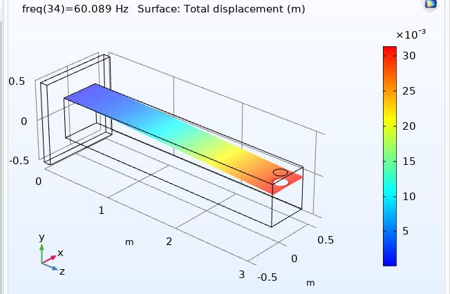

However, when I try to run the simulation under Prescribed Displacement given an amplitude of[ - 3 cm], the results are not reasonable at all: 1. the results at all frequencies are constant, 2. I should see a peak at the resonant frequency, but there is no peak which means there is something wrong [Figure 2 is attached]. On the other hand, when I put a force excitation given the amplitude only, the results are reasonable and correct.
It is perfectly working with force excitation, but not with any of prescribed Velocity/Displacement/Acceleration.
May I know where I went wrong? And why the results are not correct as am treating the prescribed displacement excitation as force excitation.

a prescribed displacement BC rigidly enforces this displacement regardless of the frequency.
Cheers Edgar

I want to generate the Transmissibility Curve of my beam system: X/Y vs f .. so I must apply base excitation on my system (i.e., forced vibrations). Thus, how to do so?

Prescribed displacement means...prescribed displacement. So of course the displacement will be independent for frequency. AND the velocity and acceleration are both directly related to the frequency in sinusoidal steady state (jomegadiplacement for velocity, -omegaomegadisplacement for acceleration) so there is no new information to be obtained.
If you want a transfer function you want a ratio between a forced quantity and a response. That could be displacement divided by force. Or vice versa. Or force divided by velocity...
Probably what you want is to apply a force and calculate the resulting displacement as a function of frequency.
