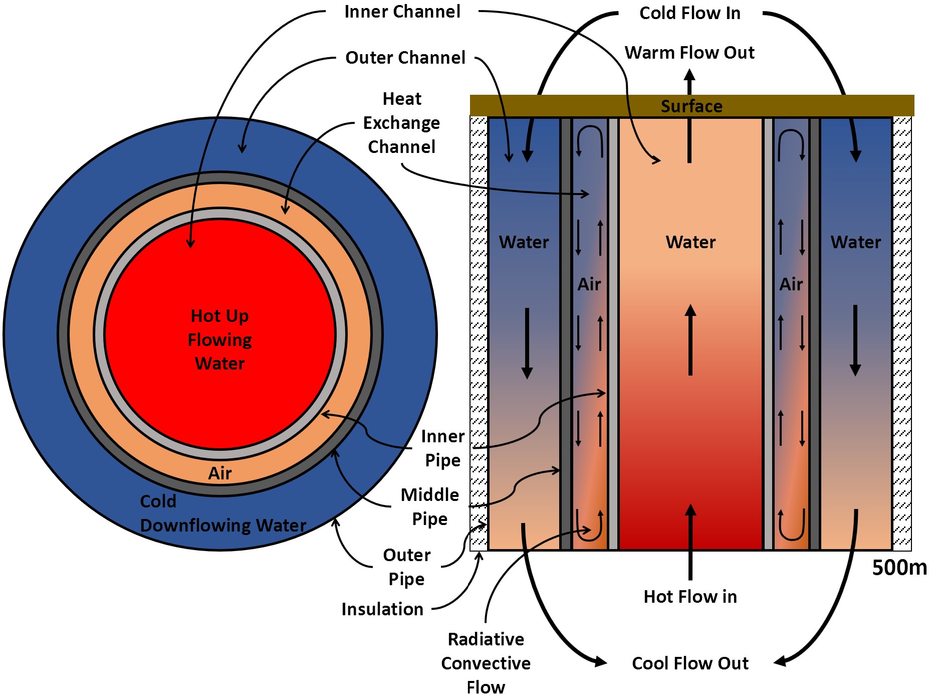

I am new to Comsol, and I think I have pieced together a somewhat functional model. However, I have a few points that I am stuck on and looking for some general feedback on my approach.
I am simulating heat exchange in 3 concentric pipes across 500m of vertical flow. Cold water enters on the surface and flows down an outer channel, which is formed by the outer surface of the middle pipe and the inner surface of the outer pipe - representing perfect insulation for now. Hot water enters at maximum depth and flows up an inner channel, which is formed by the inner surface of the inner pipe. A 3rd "heat exchange" channel is formed by the outer surface of the inner pipe, and inner surface of the middle pipe, and is a sealed volume that contains various fluids - air and water for now. Attached is an image that shows what I am trying to model.

Running that simulation gives around 15 C of heat transfer between the respective channels, which seems reasonable. Given this narrow channel, and high degree of temperature differences between the inner and middle pipe, how do I model the internal natural convection in the heat exchange channel? Looking at all the different tutorials and example models I attempted this several ways with no success. Can you all give me guidance on this?
