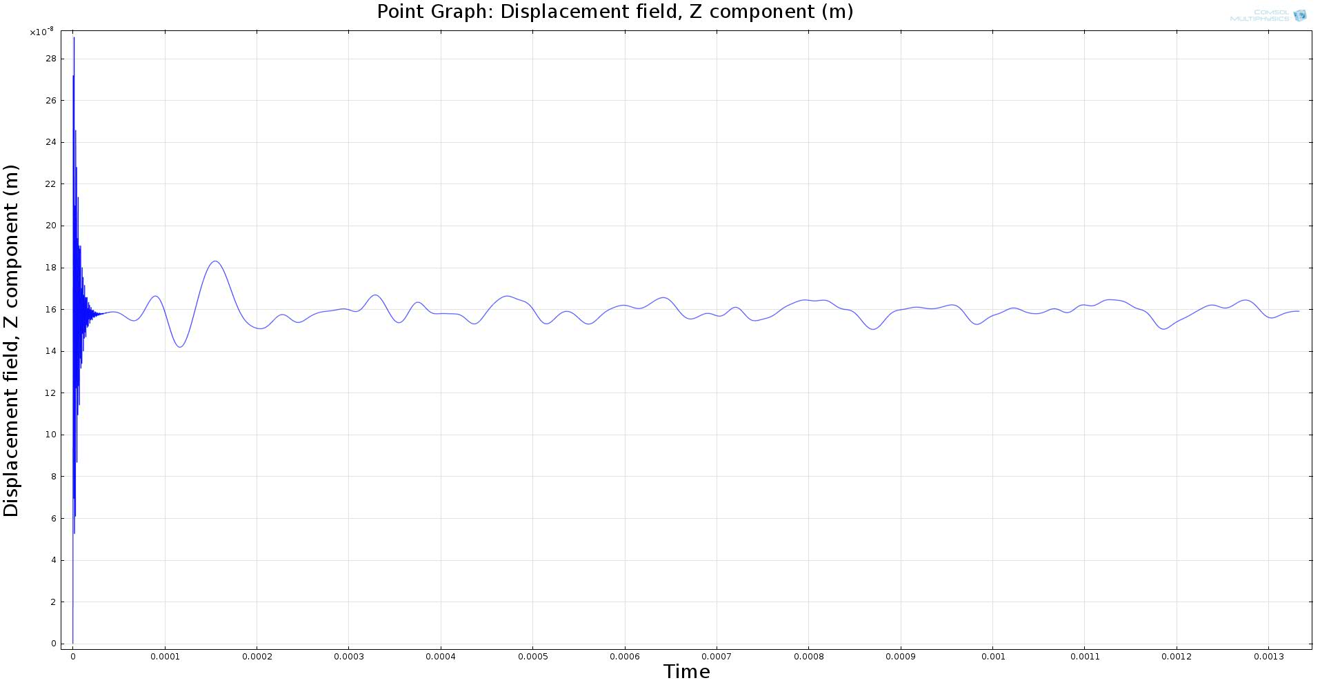

I am looking to pre-strain a membrane and am exploring the possibility of using thermal expansion to do it.
The model is a membrane 30[mm] diameter and 40[um] thickness. I use fixed constraint around the edge of the membrane.
I then add a Thermal Expansion node under Linear Elastic model 1, the values I use should give rise to 5% volumetric strain.
However, when I look at the Z displacement (normal to plane of membrane) there are vibrations. The first part of the vibrations looks like its numerical problems settling down, however there is a considerable vibration in the z direction, please see the attached.
Also, the vibrations looks to be offset by around 16e-8m, I would expect it to be at 0.
Does anyone know what might be going on here? As I do not have any material damping I think these vibrations would carry on. Also, the magnitude is about the magnitude of the displacements that I would be looking at at a alter point in the model.
Have I been stupid or is this a known problem of using Thermal Expansion as a way of inducing strain into a model.

You can conceptually apply pre-strain via thermal expansion. Why not do a stationary solution instead of having to deal with these oscillations and damping?

or perhaps turn off the inertial terms (if possible for your model) that would drop the rho*d^2_u_/dt^2 term and work in Quasi static. Often a "Continuation sweep in stationary is easier as then you are working not only "quasi" but "fully static" to the solver resolution
