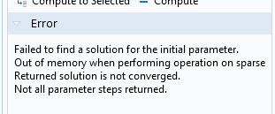

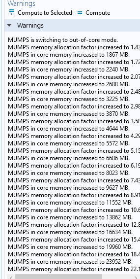

The file is too large so out of memory is shown. I am not sure that the attached file is going on a right direction. Is there anybody who helps me to see if it is correct to get my final goal and if the file is correct, is there any solutions to reduce the memory in this file? I have a lot of problem on mesh actually. If you can suggest mesh, please give me advice on that.. it is really tricky.
I have attached the file with deleted mesh and solution since the file is too large. I put the error on the solution here.
