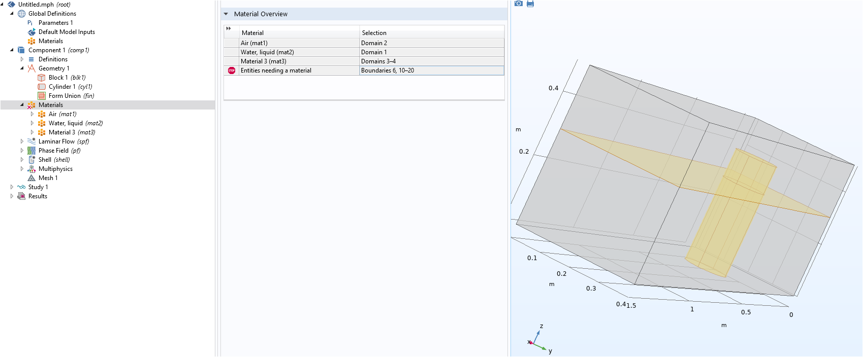

I'm a new user to COMSOL 5.5 and I'm having trouble assigning materials to my domains. I'm working in the fluid-structure interaction and multiphase flow module. My geometry is a box divided into two layers (water-air), inside which there is a cylinder partially immersed in water. The domains are 4: the part of the cylinder immersed in water, the submerged part in air, the lower part of the box (water) and the upper part of the box (air). I assigned a new material to the cylinder and water and air to two domains of the box. However, I see the red stop sign on the Materials settings: "Entities needing a material: Boundary 6, 10-20". Boundary 6 is the water-air interface, while the others boundaries belong to the cylinder. If I assigned a material to this boundaries, it is not possible to define material to the cylinder domain.
How I can solve this issue? Where is the mistake?

Hi Rosangela,
The likely cause for the boundaries to need a material definition is that the Shell interface is defined on them. It can only be defined on boundaries (shells) in 3D and requires some material properties.
Best regards, Magnus Ringh
Hi Rosangela, The likely cause for the boundaries to need a material definition is that the Shell interface is defined on them. It can only be defined on boundaries (shells) in 3D and requires some material properties. Best regards, Magnus Ringh
