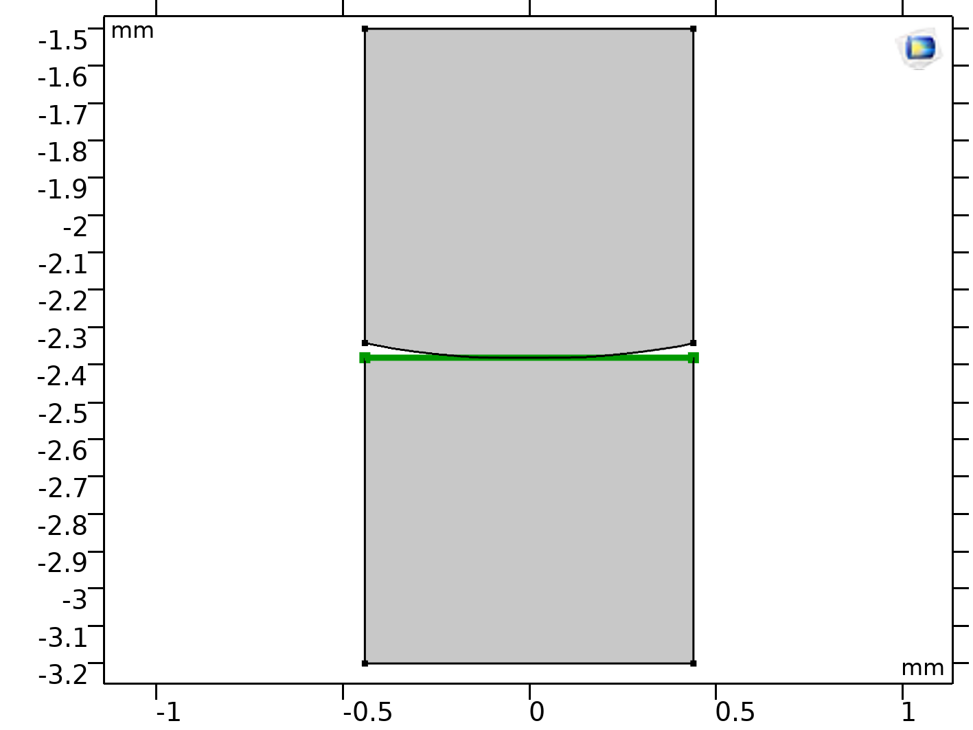

Hi.I'm modeling a contact problem between two surfaces in a 2d problem as shown in the attached figure. I cannot get the data because i got this error: "Wrong dimension of points searched for in postinterp." i use mph inter as shown below:
mphinterp(model,'solid.Tn','coord',nuevoxy,'edim','boundary','selection',4)
where nuevoxy is an array with the coordinates x and y of the points in the boundary where i wanna get this data.!

Most likely you need to use nuevoxy' instead of nuevoxy. Coordinates in Comsol are columnwise.
