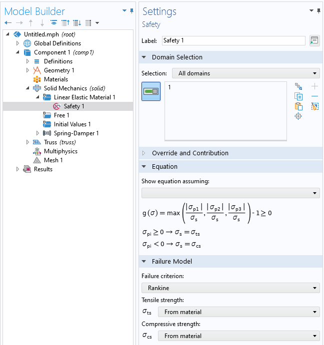

The Rankine criterion is built-in; see the attached screenshot.
