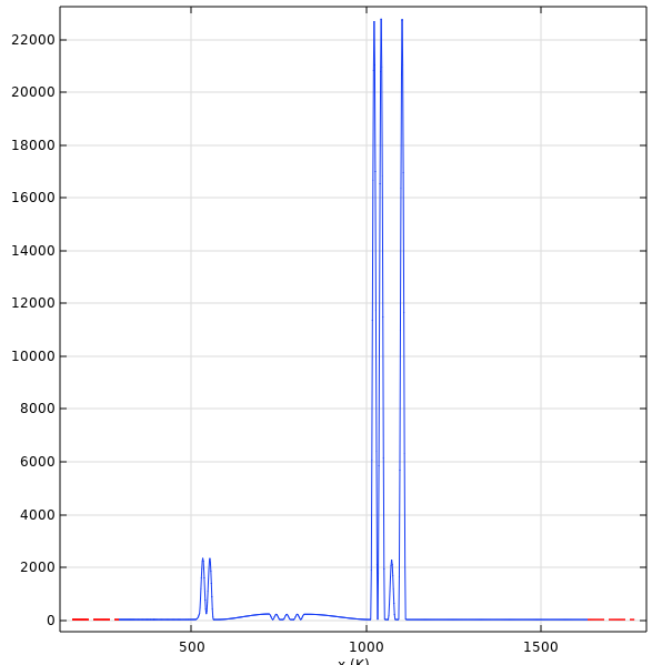

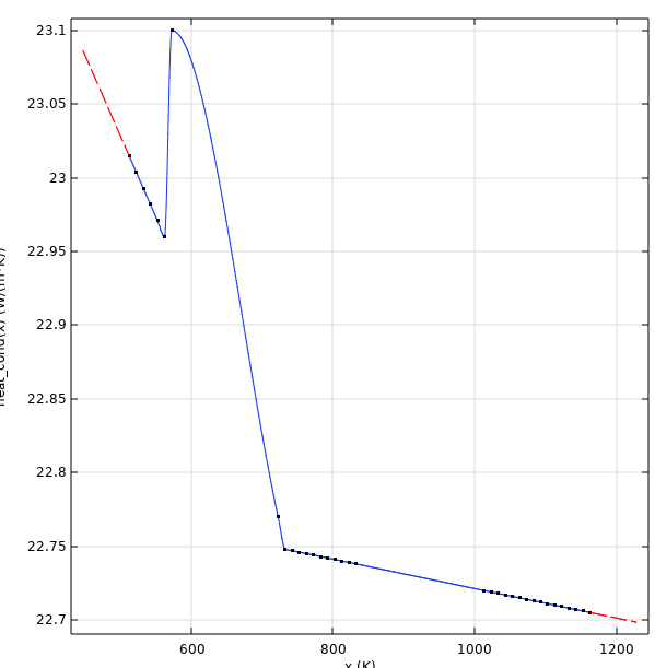

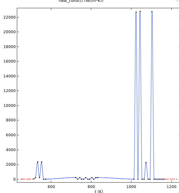

i want to visualize a interpolation function (int1) as a plot. In the beginning there is no problem with loading the data by a file (x-Range: for eg. 500-1200K) and then creating a plot. The plot created then in a new Plotgroup (pg1).

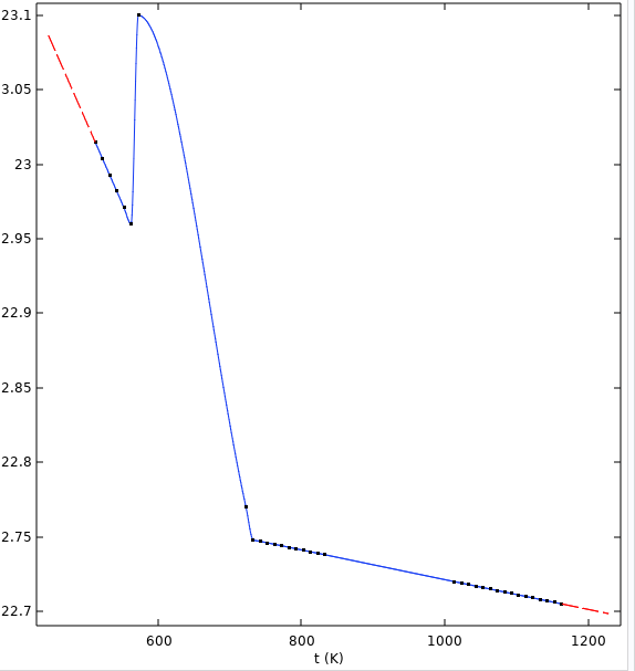

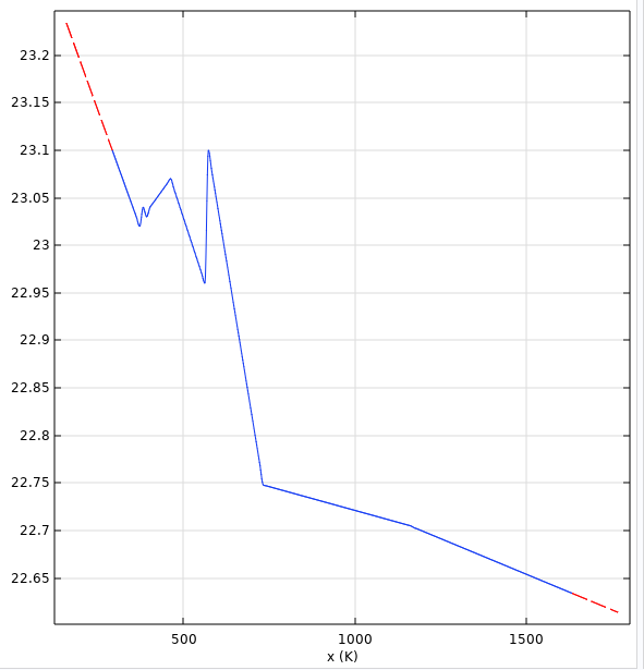

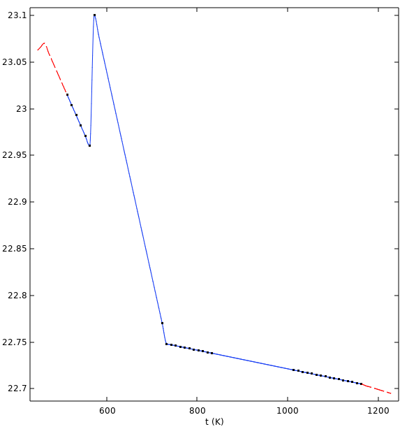

Now, i change the data in the interpolation function (int1) with another data-file. (x-Range: now 300-1600K) If i hit plot, it visualize the right plot in the graphics window. But if I click the node pg1 (Plotgroup), then it didn't refresh my results-plot.
I put some pics in the attach to show you some examples. The pics named "plot" are the plots inside the interpolation function. The pics named "plot_group" are the plots inside the plotgroup. The test.txt -Files are the data which i import into the interpolation function.
Plot 1 and Plot1_group hits perfect. But Plot2 and 3 with Plot2_group and plot3_group does not show the whole plot. I think there is a problem with the automatic adjustment of the x-range. The y-range adapts automatically.
