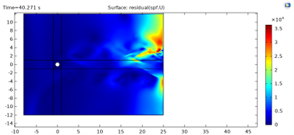

I'am trying to solve an unsteady conjugate heat flow problem for an uniformly heated cylinder in a laminar flow of water. The cylinder is located at the centerline and the inlet boundary is located at and outlet boundary at . The height of the domain is equal to .

Mesh
The mesh is mapped with quads elements and are non uniformly distributed. The statistics are shown below:
Number of elements 133200
Minimum skewness 0.4995, average 0.9889
Minimum volume versus circumradius 0.2049, average 0.774
Minimum condition number 0.2692, average 0.7876
Minimum growth rate 0.9628, average 0.9849
Boundary minimum element size 0.0134

Up to around 100000 elements the convergence is good but for finer meshes the error of the segregated solvers shows a fluctuating error after a time of around 40 seconds. The residuals also increase significantly in this period of time. These plots can be found in the attachment. Furthermore, after the error appears ''May have reached a singularity. Time: 40.593993119146752 s.Last time step is not converged.'' A plot containing undefined values of the variable comp1.T appears and is also included in the attachment. Just before the simulation quits the timestep also decreases significantly. The reciprocal of the time step plot is included in the attachment.
Can anybody help me with this problem. The effort is greatly appreciated.
