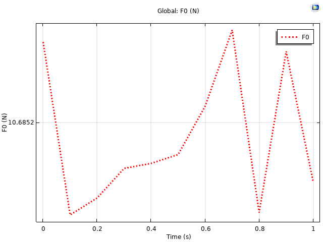

Single permanent magnet has unexpected non zero force
The attached project has single magnet and no other objects. With the "Magnetic Field" physics we expect to see zero magnetic force, but the graph of force after simulation shows a noisy, about 10N force.
What I am doing wrong?

Hmm. If I move your magnet up to the vertical center (pos z = -.01 instead of pos z = -.09) of your model, then the force drops by a factor of about 20x. This suggests that this asymmetry in the force was due to imperfections (the vertical asmmetry) in your model. Boundary conditions can never truly represent free space. Also, using finer meshes and higher order discretization reduces the force even further. So... it looks like you have numerical effects involved. You'll likely never get a "true" zero. This is a finite-element method based code.
By the way, why are you doing a time-dependent study on what seems to be a steady-state problem? Did I miss something?
Hmm. If I move your magnet up to the vertical center (pos z = -.01 instead of pos z = -.09) of your model, then the force drops by a factor of about 20x. This suggests that this asymmetry in the force was due to imperfections (the vertical asmmetry) in your model. Boundary conditions can never *truly* represent free space. Also, using finer meshes and higher order discretization reduces the force even further. So... it looks like you have numerical effects involved. You'll likely never get a "true" zero. This is a finite-element method based code. By the way, why are you doing a time-dependent study on what seems to be a steady-state problem? Did I miss something?
