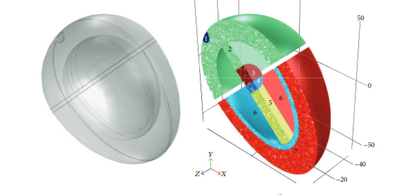

I simulated my model and would like to plot a 3D volume plot for the entire model. I would like to view it along the cross section (not a slice , the entire model).
I found a similar image from a paper employing the simulation using the comsol. I would like to know how to get the plot along any defined cross section as shown in the figure in the right? In the left its the entire geometry, but in the right the plot deomnstrates the plot along a cross section.
Thanks in advance

Hi Nikhil,
Perhaps a Filter subnode for the plot can be useful. Use a logical expression (in x, y, and z) that is true for the part of the geometry that you want to keep.
Magnus Ringh
Hi Nikhil, Perhaps a **Filter** subnode for the plot can be useful. Use a logical expression (in `x`, `y`, and `z`) that is true for the part of the geometry that you want to keep. Best regards, Magnus Ringh
