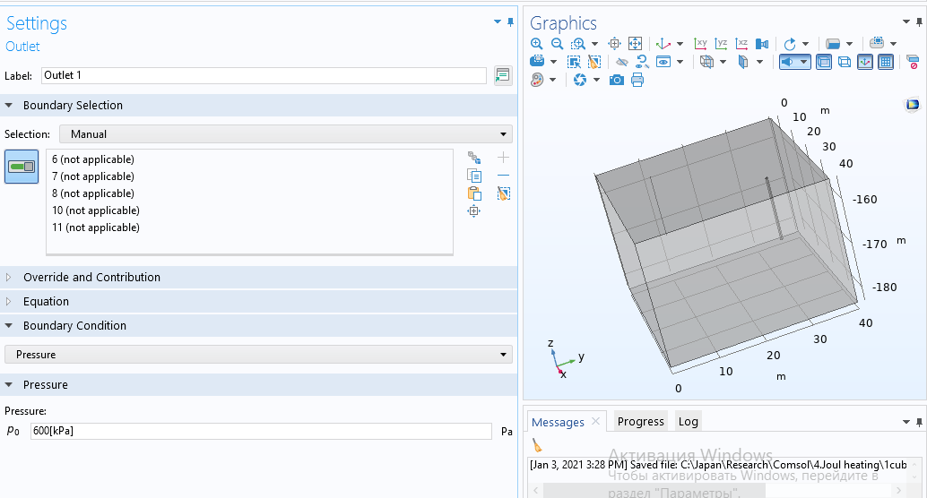

I am doing 3D simulation of filtration in porous media, I use 1 block model, material is Sands saturated by water. Filtration fluid is water, I have 1 injection well and 1 production well. For the injection wells I set the Line Mass Source condition, for the production well, I am trying to do outlet boundary condition, but it's written "not applicable" and I don't understand why. I saw video tutorials for the Geothermal Doublet, I tried to set as it was shown on the video, however now they use subsurface flow ->boundary condition "well". I am wondering how not using subsurface flow module I can set outflow boundary conditions for my production well? Thank you!
