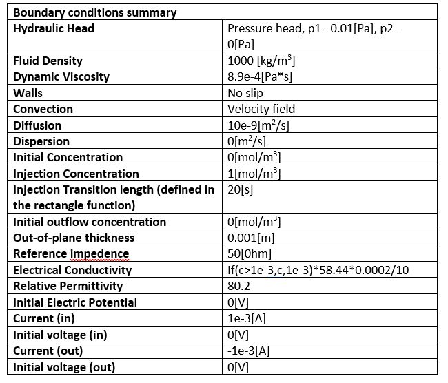

www.comsol.com/support/knowledgebase/964 I have referenced the above knowledgebase and tried the following: 1. Ramping the concentration up slowly using the rectangle function 2. Ithinkmy boundary conditions are consistent (jpeg attached for quick reference). 3. I have tried physics defined meshes at various coarsenesses, and a custom mesh at various coarsenesses. 4. I have turned off error estimates. This does produce a solution, however I'd like to avoid this approach if possible as I'd like to have an error estimate because this model is for research purposes. However I would consider this approach if it were the most logical way forward. 5. I have increased the relative error tolerance.

Any help/tips on how to get the EC node running would be much appreciated. The model file is attached (currently set to only solve the first 20[s] because it's slow).
