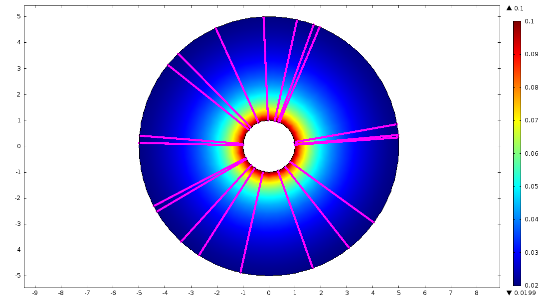

Well, that is quite interesting, please find attached an image of velocity + streamlines. Please note that I simply opened your model and just added the streamlines. I don't know what you may need to 'turn on' in comsol.

That is actually what I would like to see :)
I also simulated another case and it was the same issue. The resulting surface plot stays in an uniform colour.
