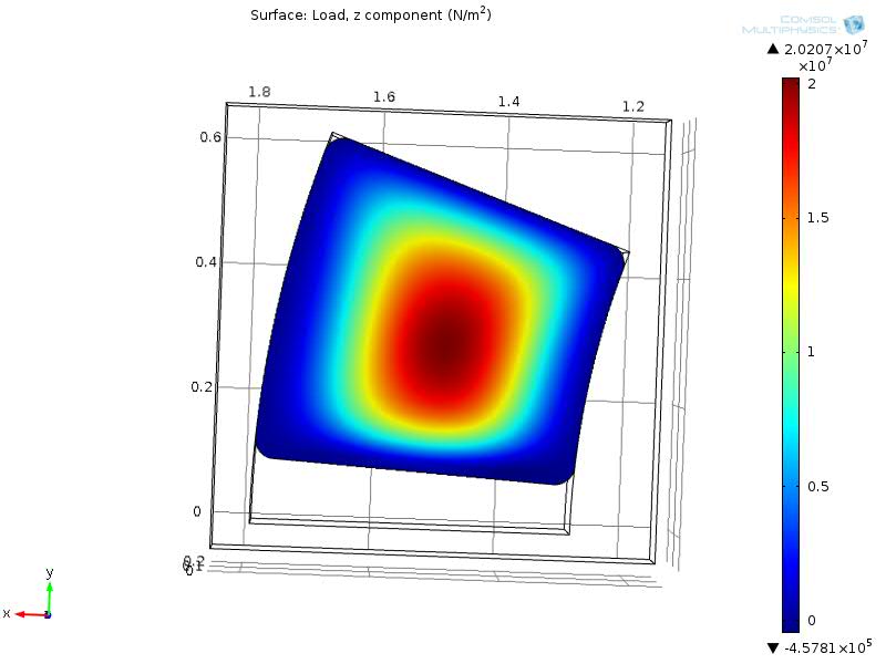

I get a pressure on a segment shaped surface using a "physic". In the real life, this surface is spinning really fast, I would like to use this pressure field (mod1.pf) to achive an axisymmetric one, and then obtain a more accurate displacement on the surface.
My idea is to use a mathematical expression to obtain an axisymmetric pressure profile taking the maximum pressure for each radius of the one I already have.
maxop1(mod1.pf) - I do not know how to input that I want the maximum for every radius,not the maximum pressure of the surface.

I have a segment shaped model. It represents the rotor(mod2). I already achieved before the pressure applied in the stator (in another model(mod1)):
Pressure applied in a segment of the stator (mod1.pf).
Since now I was applying this pressure to the rotor surface(mod2) as a Boundary Load (the snap I attached).
Then I realized that the deformation of the rotor(mod2) would be more accurate if ithe load applied was axysimmeric.
I attach a snap of the pressure I obtained from the stator(mod1.pf) applied in the rotor(mod2).
I would like it to be axisymmetric:
- To be applied in all the segment.
- Taking the maximum pressure for each radius and aplying it to all the segment radius. So no edge effects, I would like the load applied snap I attached to have the same pressure at the same distance to the centre. p = f(radius).
I hope it is clear enough. My apologises for any inconvenience.
Do not hesitate to ask me for more snaps or infromation.
