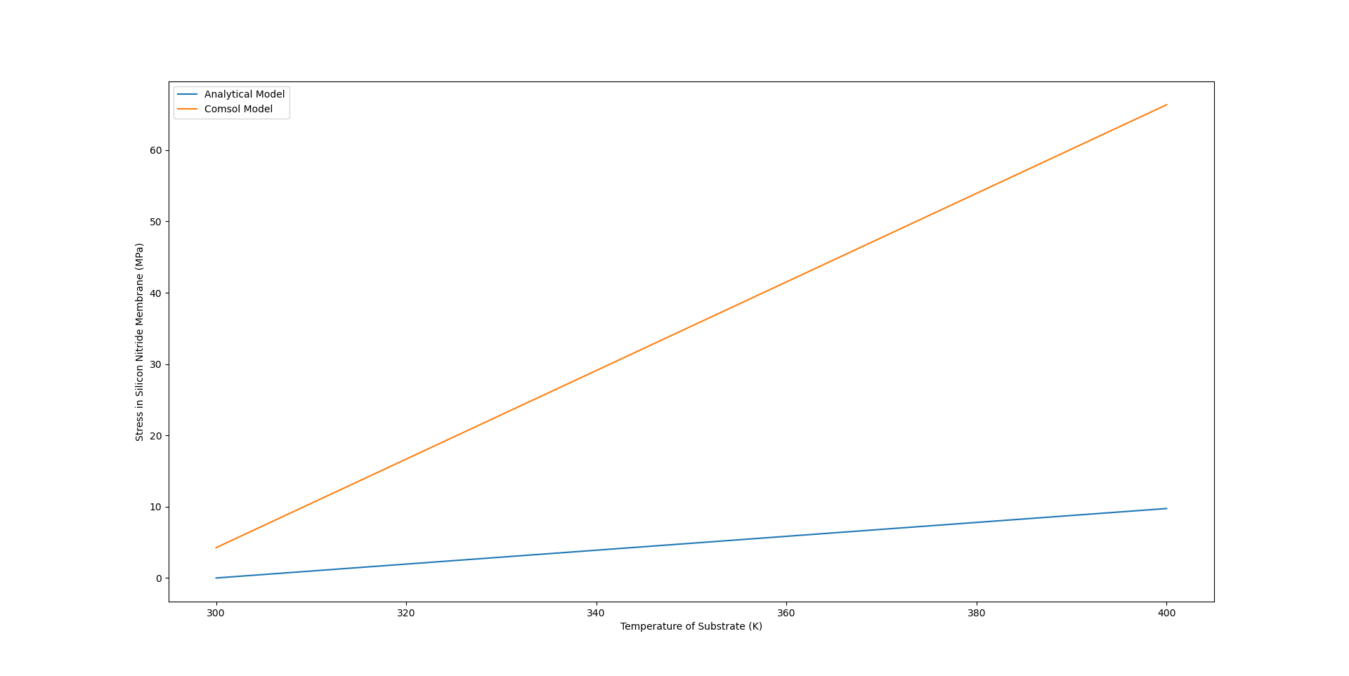

I have developped an analytical model where I assume that the deformation of the SiN will be equal to the deformation of the Si and thus I have this equation (See Attachment: Equations.png)
When you calculate it by hand, using ESiN=324675.75 MPa, CTE of SiN = 2.3E-6, CTE of Si = 2.6E-6 and Tamb = 300, TSi=TSiN=400, you get a curve that should go from 0 to 9.74 MPa.
But when I do it in Comsol, I get a curve going from 4.25 to 66.36 MPa which is a considerably different and bigger
As you can see in this image that provides the curve I get analytically VS Comsol, there is quite a big difference. (See Attachment: CurveComparison.png)
Would anyone happen to know why? I am pretty sure I have messed up the simulation in some way because I am confident of the analytical model.
