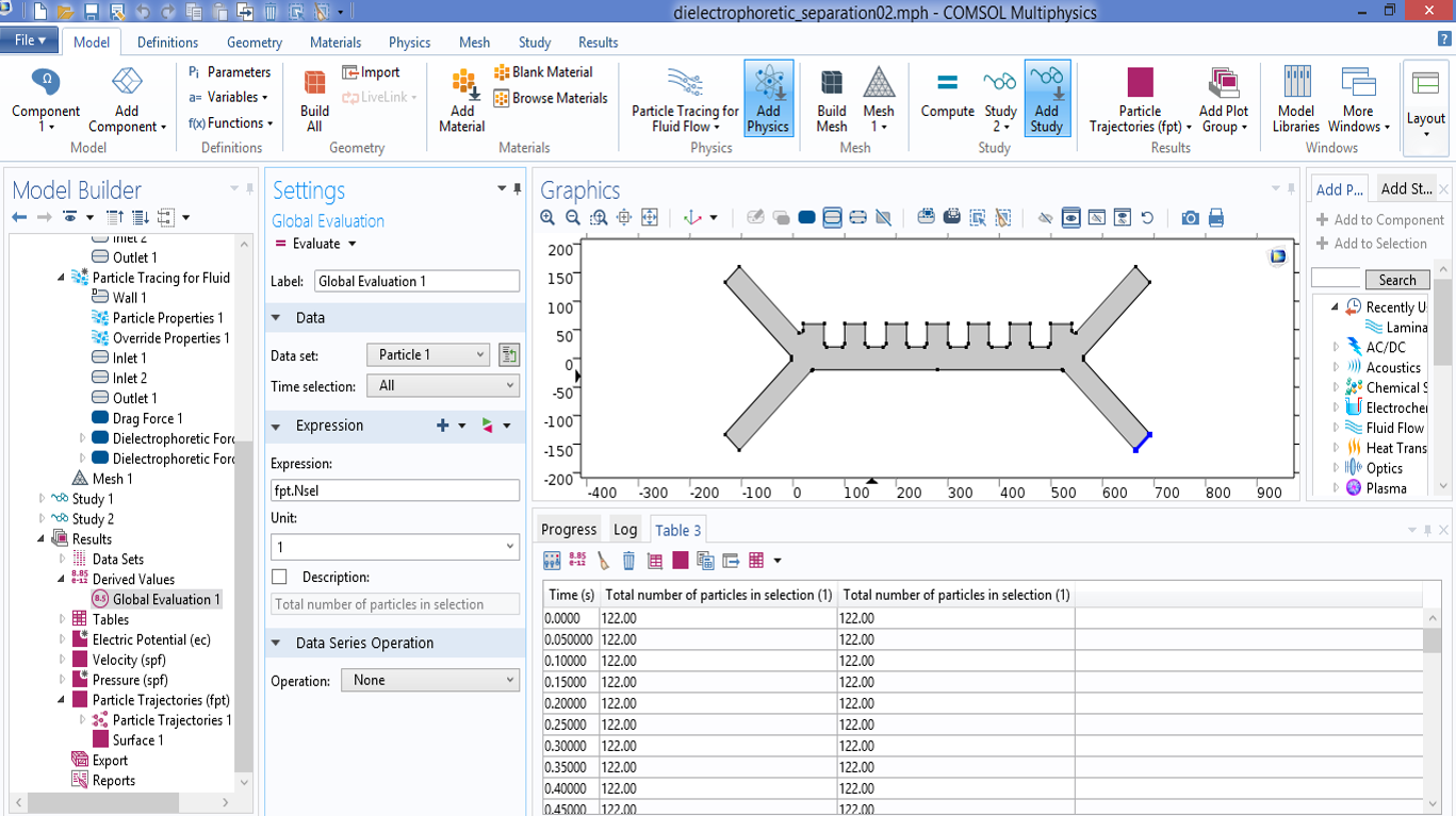

Posted: 1 decade ago 2015年7月28日 GMT+2 18:29
Under the "Global Evaluation" node, select "particle1" for "Data Set". You need also to add the "fpt.Nsel" under "expression".
Hi, Under the "Global Evaluation" node, select "particle1" for "Data Set". You need also to add the "fpt.Nsel" under "expression".
Posted: 1 decade ago 2015年7月28日 GMT+2 23:26
Thank you! I did the setting but where I can see the results after computing please?
Also, if I want to count the particle number in a specific region or passing through specific cutting surface, may I know how to do the setting? thanks for the time!
Thank you! I did the setting but where I can see the results after computing please? Also, if I want to count the particle number in a specific region or passing through specific cutting surface, may I know how to do the setting? thanks for the time!
Posted: 1 decade ago 2015年7月29日 GMT+2 19:26
You can see the no. of particles on the bottom right frame. It will show the result if you click "Evaluate". If you could not see it, try to change the tag of the bottom right frame to "Table 1".
This is basically how to calculate the no. of particles in a chosen boundary. If you want to know the no. of particles in a specific boundary, just choose it. There is also a "time selection" in your "Global evaluation" settings. This indicate the total no. of particles passing your selected boundary from the beginning to your selected time.
You can see the no. of particles on the bottom right frame. It will show the result if you click "Evaluate". If you could not see it, try to change the tag of the bottom right frame to "Table 1". This is basically how to calculate the no. of particles in a chosen boundary. If you want to know the no. of particles in a specific boundary, just choose it. There is also a "time selection" in your "Global evaluation" settings. This indicate the total no. of particles passing your selected boundary from the beginning to your selected time.

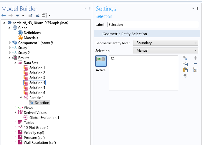

Posted: 1 decade ago 2015年8月1日 GMT+2 20:10
Please make sure to have this "selection" node under "particles", and choose the boundary you want (see attached file). I believe that is the reason why you only have the total no. of particles.
Hi, Please make sure to have this "selection" node under "particles", and choose the boundary you want (see attached file). I believe that is the reason why you only have the total no. of particles.
Posted: 1 decade ago 2015年8月1日 GMT+2 23:12

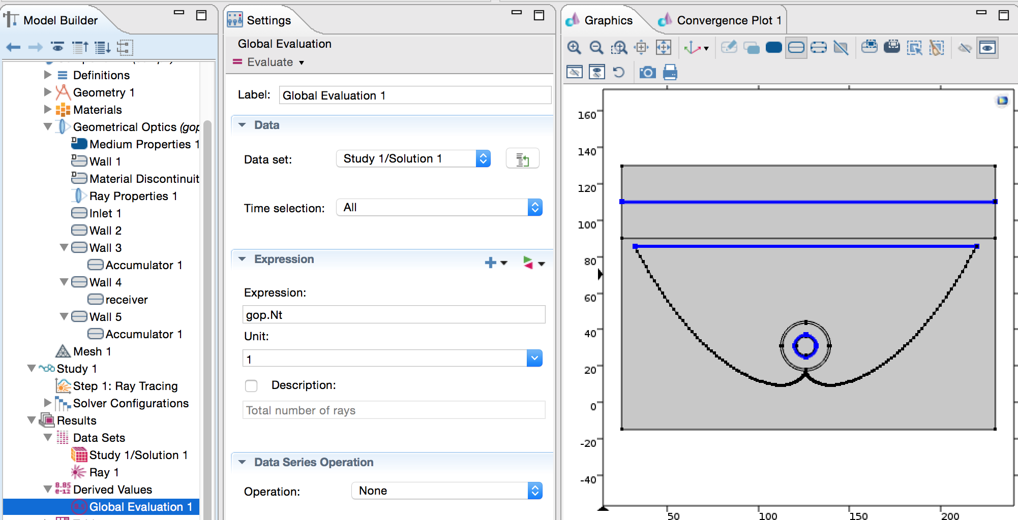

Posted: 1 decade ago 2015年8月12日 GMT+2 16:06
I'm doing something similar only for a ray trace simulation. How do I count the number of rays in a particular wall?
Hi, I'm doing something similar only for a ray trace simulation. How do I count the number of rays in a particular wall?
