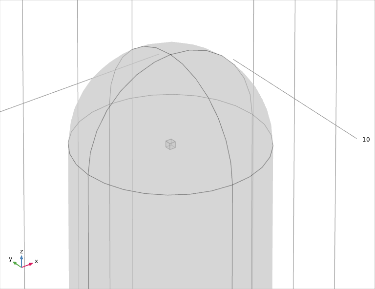

One last question, do you have any recommendation/advice for simulating electrostatics (potential, field) for 3D geometry? I tried creating electrodes and defined it as floating potential, ground at the bottom (screenshot attached) but nothing is happening. Do I need additional boundaries to simulate?
Thanks!

If some boundaries are grounded, some boundaries are set to floating potential, and the remaning boundaries are zero charge, then the solution to the problem is voltage equals zero everywhere (I figure this is what you mean by "nothing is happening"), so not a very interesting set up. Maybe you meant to impose a (non-zero) potential at the boundaries that you made floating potential?
It's quite possible I am not understanding you correctly. If your difficulties persist, I'd encourage you to work through one or two tutorials on electrostatics in the Application Gallery.
