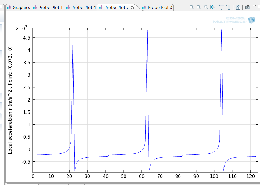

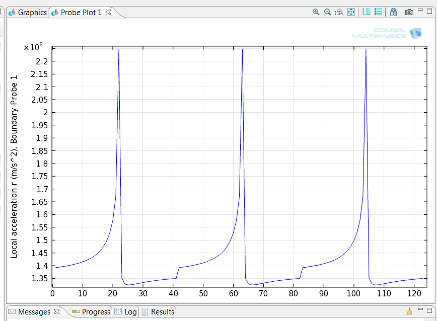

Initially the probe plots (9total) is a 3 spikes (acceleration vs. number of values computed consecutively for each corresponding user-defined internal pressures). I've chosen 0 300 600 psi, respectively.
When running the Pre-stress (study1) and then Frequency Domain (study2) the Result tab shows a generated tables values with accelerations (i#) for the 9 probes mounted onto the shell, evaluated over a frequency 16905-16920 Hz, step size 0.25. When the calculations are re-run the 3spikes now has a different x axis replaced with ExtPressure, not 0-123 steps (41 for each pressure defined), which is the consecutive sum of the frequency range/step size for each pressure evaluated. The issue may be a Parameter problem. Both desire 3-peaks and the generated plots w/ x-axis EXTPressure have the same Table values, just different representation.
How can I get Comsol to generate the initial 3 spikes with the # of evaluated steps on the x-axis for different external pressure say: 0 100 600 psi every time we compute study 1 & 2 is re-computed from initial file state?
I ignore the irrelevant study 3 (eigenvalues) .
See attached problem file and Pictures of the two desired probe plots with the right x-axis.

if you define a (or several) probes, you will get a probe plot node, therein you can change the default settings for inner/outer, x value etc
You need to start the solving process at least one iteration to get COMSOL to generate the default nodes, then interrupt the solver, set your plot values, clear the solution and restart your solver
