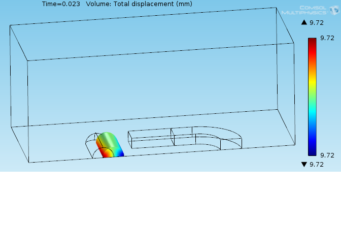

There are multiple issues in your “permanent_magnet.mph” setup.
Some (not all) issues are listed below.
Solid Mechanics:
- Air domain should not be included
- Body load should be applied to the solid part which is moving (not to all domains)
- Replace Fixed Constraint by appropriate constraints along symmetry planes
- Prescribed Displacement node is not needed since movement of the solid body is governed by Body Load
Moving Mesh:
- Free Deformation should include only domain where is deformed, i.e. air domain
- Symmetry constraints are needed for two symmetry planes. These constraints are imposed by Prescribed Mesh Displacement Nodes
-There is no coupling between Mowing Mesh and Solid Mechanics nodes
Attached is working mph file of your model for the case when magnet is fixed and rod is moving. This is not an attempt to solve your specific problem but to show general setup steps for Magnetic/Solid/Moving Mesh coupling.
Note, that you can replace Solid Mechanics node by ODE and DAE Interface if you are not interested in deformation of moving solid – see example “Magnet Falling through Copper Tube” from Comsol Model Library.
Sergei

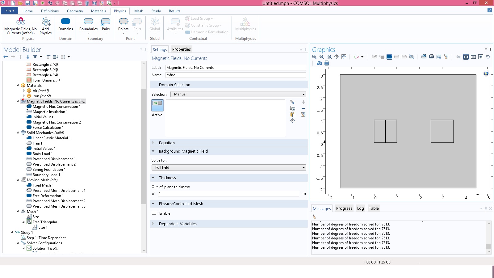

Hello Mr. Yushanov,
I have been trying to do the same with 2D model witth square shapes. I implemented the familiar steps but result is failure. Can you help me to solve this?
Sincerely.
Hello Mr. Yushanov, I have been trying to do the same with 2D model witth square shapes. I implemented the familiar steps but result is failure. Can you help me to solve this? Sincerely.
Posted: 10 years ago 2016年1月23日 GMT+1 23:21
At most I can get NaN value :) and no motion in animation.
