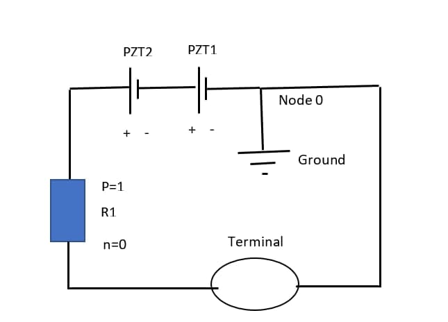

Let's then propose this question as well. Let's imagine I have two separate piezoelectric layers. They are creating voltage. on the electrostatic -> ground : I have boudaries 1, 2 on the electrostatic -> terminal : I have boundaries 3, 4.
My circuit is comprised of : Ground node, resistor , and external terminal. The ground node is p on node 0 The resistor is p on node 1 and n on node 0 The external ternal uses the same node as in electrostatic.
what will be the configuration to connect them in series and parallel? Do I need to swap boudaries on electrostatic?

Ok, Here is a rough schematic of what I am trying to do. (please see attachments)

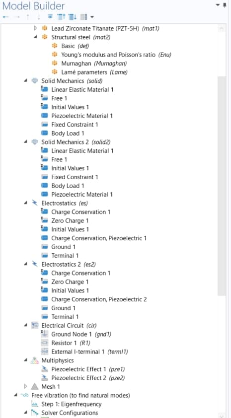

I understood, since I had 2 bodies but only 1 solid mechanics and 1 electrostatic physics, they were not each working separatly. I made them two separate physics like * solid mechanic1 * electrostatic1 * solid mechanic2 * electrostatic2 * and then * 1 electric circuit.
Would someone please confirm if this is how I should do it?
