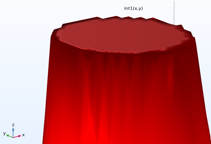

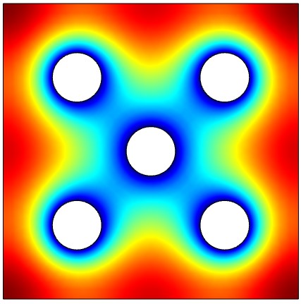

I have a Height Expressions that obtained from a 2-D problem solution and I'm trying to create a 3D Fluid surface whose one boundary is be determined by the Height Expression.
I export Height Expression (XYZ) data to "txt" or "excel sheet", then I import my data back to COMSOL via "Functions -> Interpolation". However, in this step (3D-> Geometry -> Parametric Surface ), COMSOL is creating the surfaces that are actually empty in the analysis and gives zero value. At this step surface is spoiled due to the interpolation (see attached file) near "virtually generated" surfaces and gives a significant error. (Please see attached files for difference and spoiled surfaces.)
Is there a way to convert Height Expression directly to a 3D surface or to accurately re-import the results? Many thanks, Goksel
