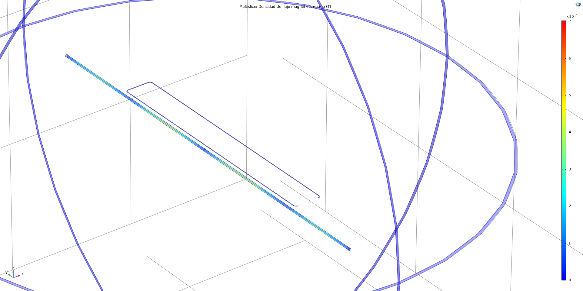

Good morning,
I have an issue with a 3D model. I am trying to show the magnetic field created by a DC current (10 amps) trough a straight wire, I have chosen magnetic fields and electrics (steady), and the result after calculate do not show this magnetic field, just a very low value... Even when rise the current (till 100 amps), it does not change... I have done it in 3.5 version in 2D and works very well. I do not know what I am missing.
Thanks in advance for help
Greetings

thanks Robert,
sure, you can find it attached the image with the results (magnetic flux density)
thanks Robert, sure, you can find it attached the image with the results (magnetic flux density)
