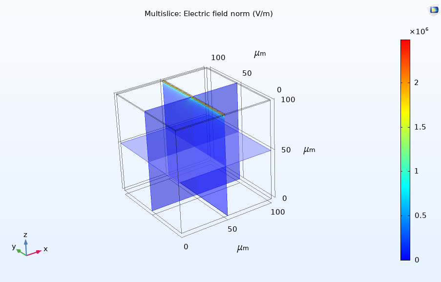

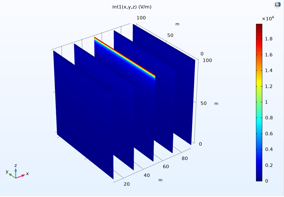

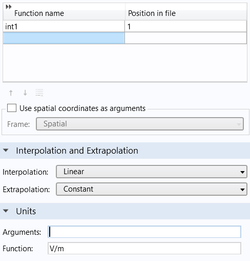

I really appreciate your answer .. it is very useful .. Thank you so much If you look to Figure-1, This is the Data that I want to export. I exported as you mention.. At Figure-2, I use this data in Interpolation Function as you mention.. - What should I write in Arguments box or should I change the “Use spatial coordinates as arguments” as it is shown in Figure-3? - Is there a way to control the accuracy of the data that used in this function? - Finally, How can I use this function? I want to use it in RF module…
