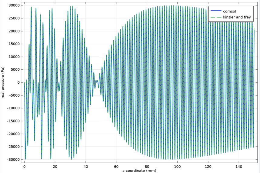

I simplified the attached model in the following ways: constant water material properties, no losses, and velocity boundary condition on the piston surface. This allows for direct comparison with analytical solution, for example section 7.4 in Kinsler and Frey. Here the radiation field from a circular piston is derived and an exact expression for complex acoustic pressure along the acoustic (z) axis can be determined.
When I compare the attached model to the analytical expression, the agreement is quite well (see 1D plot group "axial pressure (Pa)". The analytical expression for complex pressure is computed and stored as a variable in definitions.
Hi Ken, To what are you benchmarking this model against? I simplified the attached model in the following ways: constant water material properties, no losses, and velocity boundary condition on the piston surface. This allows for direct comparison with analytical solution, for example section 7.4 in Kinsler and Frey. Here the radiation field from a circular piston is derived and an exact expression for complex acoustic pressure along the acoustic (z) axis can be determined. When I compare the attached model to the analytical expression, the agreement is quite well (see 1D plot group "axial pressure (Pa)". The analytical expression for complex pressure is computed and stored as a variable in definitions.

Hi Ken, I think I chose the velocity boundary condition just to match the analytical case, but I don't see a specific advantage over a normal displacement. The value used was not selected for any specific reason, just to check against the benchmark.
